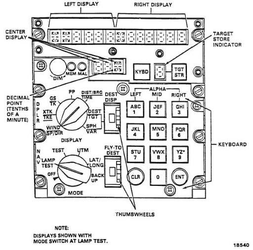

Doppler Navigation Display Unit: ASN-1252/ASN-128
Note: As this unit has been gutted I will have to do all the work.
You can find a user manual here TM-1-1520-240-10 or you can find a nice pdf version here the unit is described in Section 3.3.11
Plan: 2 ardunios
  1. For the display and CANaerospace interface. The display is not LED-powered but incandescent bulbs.
    Since there are 13 7-segment displays and an additional 4 16-segment displays.  I can most likely use 2 3: 7 segment decoders as of TTL loads
    I going to use Tri-State Buffers driven by PCM to control brightness.
  2. For the keyboard and all the switches under interupt control.

    • I have changed my approach. To the design of how it's design to get this beast to function, this will be accomplished by using 2 Ardunio. Vegas one just to run the display  since there's as i have a mix of alpha & 7 seg displays, I have to use 16 bit gpio and run the. statically.
    • The second cpu handles quite alt
    • A. Transmitting am receiving  messages from the cam bus
    • B. keeping track of which display it needs to us
    • B. Encoding the keyboard and 4 other switched.
    • D.. TALKING the other cpu two items 1
    • 1.  The ascii letter /number
    • 2.   Which display
    Oh yes you need to run incandescent things at 4 volts to boot
    .so currently that's 3 boxes
    CP-1252 the computer display. And keyboards and switches.
    There will be an i interface box which cxu termination  between echo boxes
    last there is the.LRU which talks to the can . And the Sim itself.
