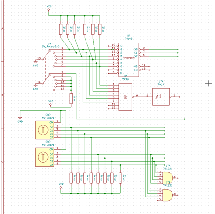

Oh my lord back to this monster again. I took another look at what's really going on in this thing. image
  • Display Switch
  • Mode Switch
  • Thumb Switch 1
  • Thumb Switch 2
  • int 1
  • int 2
  • int 3
  • int 4
  • Keyboard
  • int 5
  • Communications
  • int 0
I have broken it down into functional sections. By using the Arduino Mega I have  6 hardware interrupts 0 - 5, which will take care of the I/O.  Below you can see my logic for the hardware.
Basically by grounding the common of the switch which is the input to 8 to 3 priority encoder, which is normally pulled high. the encoder will output the code in binary. To make sure that my signal is clean I have employed an 8way NAND gate as well. The output signal of the gate is an input to a Schmitt trigger which is cleaned via an RC network shown below. Due to the limited amount of hardware interrupts I will have to do something called soft interrupts. basically all of the NAND gates go into an 8 to 3 priority encoder. The inputs also are wired to a NAND gate and Schmitt trigger when the Arduino sees the Interrupt line active it looks at 3 bits from the priority encoder.  This number from the priority encoder is the ISR that is then called. This may sound like a run-around but it does work, it is called 2 level interrupts.imageimage
