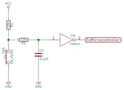

These three images are  from  "Embed With Elliot: Debounce Your Noisy Buttons"
Why do I say aftermath? Well to put it simply it might have been a bit of an overreach.  I spent more than a few days trying in vain to get the display board pins identified.  So here are some videos for the Fuel Load Indicator.  First up are the function switches.
image image
BEFORE RC Circuit
There is one more board and that is the Signal Conditioner. This is a small board that connects to the switches and the Interface board. The Signal Conditioner is a  simple RC network where, T = C * R, or .001 seconds,  to get rid of the jitter or ringing.
I am using interrupts from the switches provided by an SN74LS147 which is a 7-inputs to BCD outputs that triggers the interrupt. To get the 3-bit outputs (Arduino inputs) into one integer I used the bit shifting:
