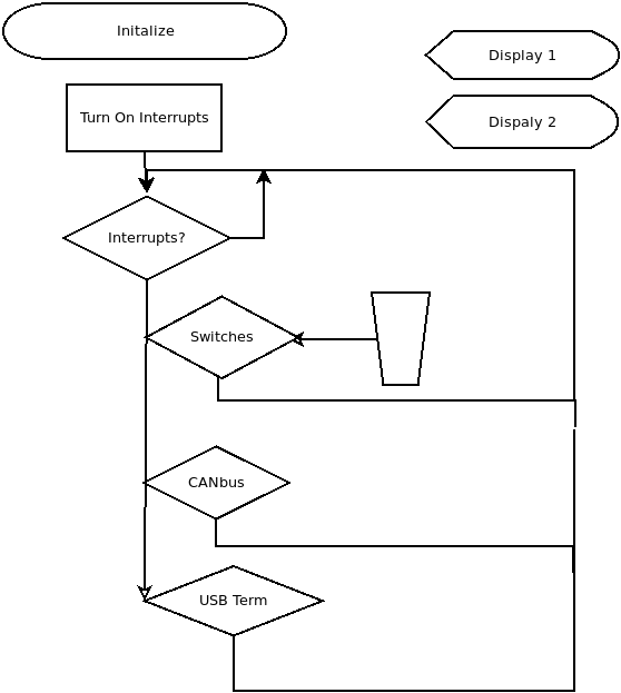

imageAs this node will be fairly busy, I have decided to implement this with interrupts.  The interrupts come from one of three (3) devices: CANaerospace Bus interface, USB term, one (1) of 2 switches, each with two(2) positions.image
CANaerospace Bus:
Hardware - Software Design:
  1. On of two switches, each with two positions.
  2. CANaerospace Bus
  3. TTY1(USB)
This node can respond to messages for ID#:
  • 0 IDS
  • 668-675: Fuel Tank in Quantity (US GAL)
  • 676-683: Fuel Tank Temperature (F)
  • 1301: Total fuel on board weight
Switches: To handle the 4 choices set P -Down and TEST - FILL. I will use a 7 to BCD priority encoder coupled to a Schmitt Trigger. I will use the following functions:
  1. void upTank up()
  2. void downTank down()
  3. void test() ::= Turns on all bits in both displays, waits about 30sec and then print(display) display1: BITE TEST,  display2 OK vxx
  4. fill( int curTank)::= Diplay1 curTank; Diplay2 Filled when fuel in curTank == #maxTank 75.0; etc.
