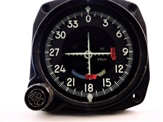

imageimage The last time I blogged about this unit was back in October 2016. So I uncovered it in the "un-move" along with a cable which I had thought was just a spare but nope it belonged to this beast. Basically, it's a Resolver that drives the 'bug' or pointer and 'OBS' there is also a manual control to set the bug on the heading you desire. Currently, the 'bug' is at 0, and the 'OBS' which is the reverse is at 180.
CPP Phase Shifter 30 ~ Wires
Type PS-17-E-1
Stator 2 phase 5 volts Black & Yellow
Purple & Green
Rotor 1 phase 5 volts White & Red
The following pinout and signal/component information came from TM 11-5826-215-35 figure 76.1.
