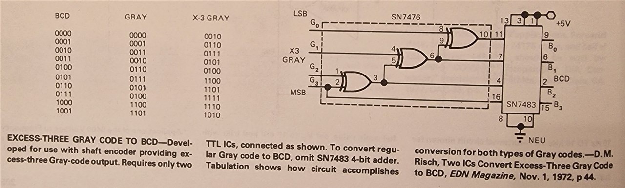

    I'm not super-familiar with ways to do the conversion, however there's an ancient circuit in an ancient book (with an anachronistic name nowadays: Modern Electronic Circuits Reference Manual), that might help, it is asynchronous, but seems to work. This circuit is also on the Internet Archive so probably OK to reproduce here.
    This uses three XOR gates (the SN7483 chip on the right is not used):

    Hi thanks for the check-up BUT what you printed out as GRAY is not Gray Code (2 of 5 and negative active. I will have to add pull-up resistors to the Gray code inputs.)) This format is widely used in the aircraft industry. and I think there is a A

    shabaz over 4 years ago in reply to phoenixcomm
    Oh, wow - not seen that code before. I can't figure out what the pattern is in there.
    However, I think I now understand the use-case; you will be taking the gray code into a microcontroller, using the MCP IO expander chip.
    Based on that, the bottleneck on performance will be the bus speed for the I/O expander (I2C or SPI speed). The reading of the gray code (or any code from slow devices like rotary switches) is a very common scenario for the MCP with interrupts. This is the way it is usually done:
    (1) set up the MCP chip to generate an interrupt-on-change, i.e. whether any input goes high or low, you want the interrupt.
    (2) Have the A..E connections wired to the MCP chip, however looking at the code, you could just wire up A..D, or B..F, since 4 of the connections still generates a totally unique code, the 5 connections have some redundancy. It's up to you, but personally I'd just use 4 of them, since there are other points of failure since this isn't going into an aircraft environment.
    (3) In the code, whenever an interrupt occurs, read the MCP chip into a variable called (say) graycode. There are two choices, to read during the interrupt, or to set a memory location (you're using it like a flag) to indicate to code outside the interrupt to read the MCP chip. If you're using SPI, then it could be OK to just do it in the interrupt, otherwise personally I'd do it outside of the interrupt using the memory location as a flag.
    (4) Make sure you're only using the 4 or 5 bits in your code, i.e. if you're using 4 bits:
        graycode = graycode & 0x0f;
    (4) The code will have a const array. For example, if you're using pins A..D, then the const array will contain this:
      const unsigned char bcdmap[10] = {8, 9, 99, 7, 2, 6, 5, 99, 1, 0, 4, 99, 3, 99, 99, 99};
    The value 99 is an unexpected value, so you can have some error message printed out in those unexpected cases.
    (5) Convert out your rotary switch (or whatever the gray code is coming from) using this:
    value = bcdmap[graycode];
    The variable called value now contains the gray code result, and this is super-quick, very few resources used on the microcontroller.
