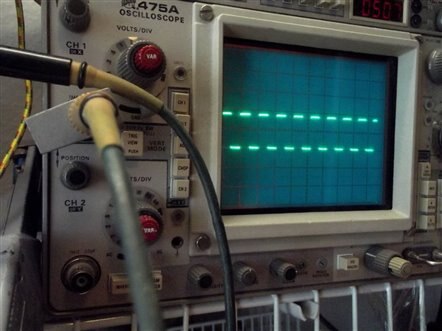

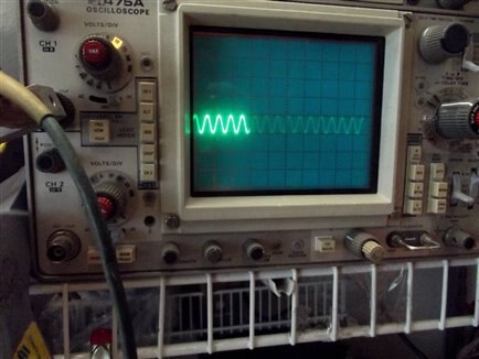

All is now well most of my noise was coming from two sources.
  1. Power bridge needed resoldering!
  2. Scope probe not grounded!
It is now all buttoned up and on the shelf!
Here are some pictures.
Test Setupimage
Sine Waveimage
