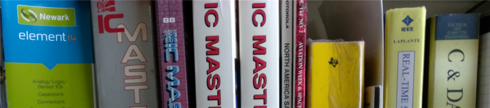

Ok, So you think you have a library, what maybe a dozen or so books lying and a few pdfs around? Well at the last big count, I was well over 1000, some are still in boxes, and some are lost forever. So you really should organize it. I Have a large collection of various books, Fiction (first editions of Robert Ludlam and Isaac Asimov), Cooking Books, Lots of Movies, and DIY shows, well you get the idea.
So you need to organize it. Your choices are very limited:
  • Dewy (like in your local and maybe your school library. I found it horrible for a technical library. Enter LC.
  • LC or Library of Congress is a very complete catalog system. If you use it there will be a learning curve. The biggest holes are product catalogs and military manuals.
To set up an LC@home you will need to download some background info:
  • How to read an LC Call Number.  This number is printed in most books on the page with the publisher data. If not you can look it up yourself.
  • Library of Congress Control Number. This is another number used by LC and is linked to MARC 21 record.
  • Fundamentals of Library of Congress Classification
  • LC Cutter Number System
Set aside shelves for your major class and subclass, some of mine include PS (American literature),  QA (Mathematics), TK (Electrical engineering.), TL (Aeronautics. Astronautics).
I have built a dB with MySQL for keeping track of my 'STUFF'. I'm going to show you how I did it. It still needs a lot of improvement. I have 3 tables Author, Publisher, and Books.

Now with all that said the last thing that I published on E14 was the Lambda Catalog and Application Handbook (1974).pdf This is one of the wonderful things that do not have an LC Control or Call Numbers. So I guess I have to add it to my local repository.  It will fit nicely into TK where my IC Masters and TI Databooks are. I don't have an author, but I do have a publisher (Lambda Electronics).
But First I have to add Lambda Electronics to both the Author and Publisher tables. In this case it is also the Author, By using The Cataloging Calculator and Checking LC Cutter box I got a new Cutter Number of L36333 and then add the year 1974, I ended up with an LC Call Number of TK L36333 1974 when this book is added to the dB I checked type: and selected PDF. and presto it's in the system now.

    phoenixcomm over 8 years ago in reply to DAB
    Dab, I don't know about you but I  have a huge collection, to help first thing you need to do I take your books and sort through them, make a 4 or 5 piles. Mine are Computer Science, Electrical Engineering, Aerodynamics, Fiction,  and Cooking. I put them on separate shelves which I numbered by Shelf Unit(Number) and Shelf (Letter) Now put your sorted books on the Shelves and that's a start.  So, QA (computer science) is on 1D, 1C, and 1B (shelves start with A on the bottom and go to E or higher on the top. I made the bottom shelves a little taller to hold binders.  I keep some in my office above my desk (see the picture above). This should get you started.
