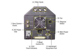

imageOh well this is one of those things that has been sitting around doing nothing... And all I need to do is build yet another cable.. It was a prototype made by  Precision Display Technologies. Their part number is MPCDX-PROTO, which is for the F/A-18C/D.
Fig 1. F/A-18C/D MPCD prototype

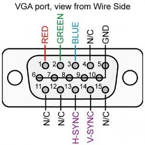

The Analysis:  Well it looks like I need a VGA cable to go to a component input.. So what signals are in a VGA cable?  So a quick look and I found this picture (Fig 2). So I need a cable that will start as VGA cable and end up with 4 BNC connectors RGB+Sync.
Fig 2. Rear
The Plan:  Well getting a VGA Cable is a no-brainer there all over the place.. Next we need the other end. As I have lots of Sun Microsystems Cables, one of them is a DB13W3 to BNC cable.  So now all I have to do is cut the cables in half and put them back right? Sounds good.. The Bezel Control I/O will have to wait for another day.
Fig 3 VGA Pinout
VGA Pin and Color VGA Wire DB13W3 Wire
1 RED RED RED
2 Green YELLOW GREEN
3 Blue BLUE BLUE
13 H Sync RED BLACK
14 V Sync N/A GRAY
5 Ground Black Shield
Table 1. VGA Connector

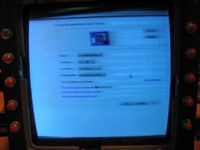

LATER:  Ok So I wired it up as per the above table and got this: (Fig 4)
  I have to download there software to adjust the CRT its all done with software...
Fig 4. Working monitor needing adjustment

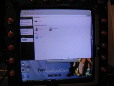

MUCH LATER: Oh well my cable did not work right and the display would not lock vertically. During  a call  today  with John, at Precision Display Technologies,  he suggested that I need to use both syncs. As this unit will use three types of syncs:
  1. syncs(2) on green,
  2. combined syncs,
  3. separate syncs.
VGA Pin and Color VGA Cable PS3 Cable
1 RED RED RED
3 Blue BLUE BLUE
13 H Sync RED Red/Blk
14 V Sync GRAY Blue/Blk
Table 2. VGA to 4 BNC Cable

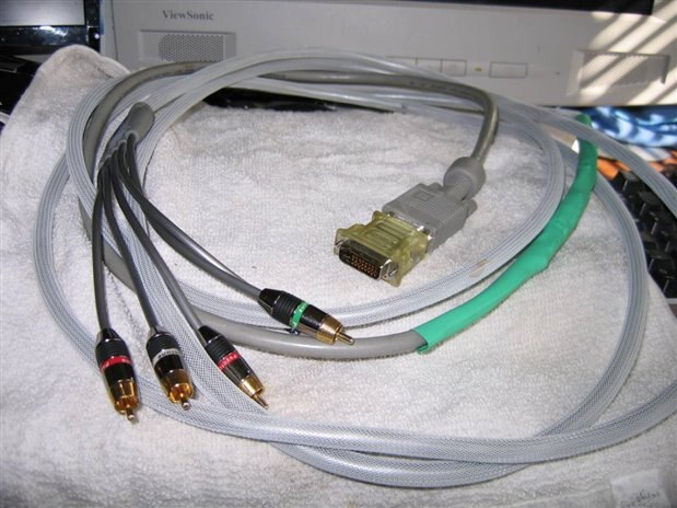

Salvaged from a PS3 Game Cable
Fig 8. PS2/3 Psyclone 12 foot video Cable
So a quick jumper between the Gray sync wire and the VSync confirmed this. Table 1 is out and Table 2 is in.  It looks like I will need CABLE v2. So the DB13W3 is out as it only has 4 BNC connectors and I need 5;  RBG + 2 syncs. I remembered that I just picked up a PS3 Component Video Cable( Figure 8 )... It sounds like I have my new sacrifice!!

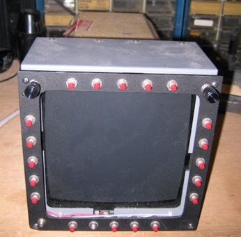

Ok all ended well that is well and it all works..
Fig 5. Working monitor
I have to adjust the resolution..
Fig 6. The new cable thats shorted...
LATER: FEB 18, 2014  well here is the new cable, you will notice there is a DVI - VGA at the end of the cable. GROAN: Do you see whats wrong?? yup the ends are RCA-Phono not BNC connectors.... Looks like I need some adapters (see Fig 7)..
A Few Days Later:  It looks like there was a whisker shorting out the Blue.. GROAN: Ok the fix is painful. I have to cut down the shrink wrap and then the electrical tape and two layers of shrink wrap over the Blue it self.
