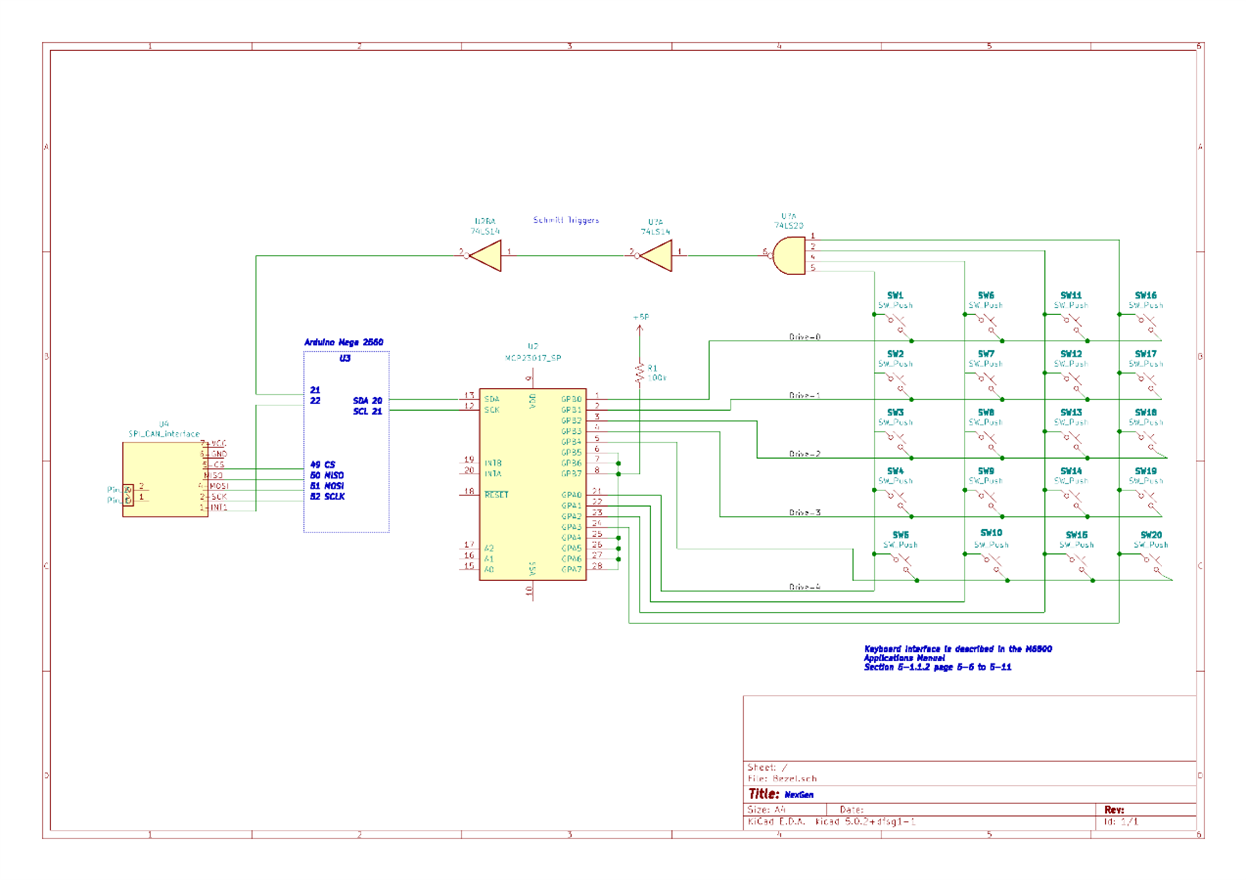

I have been down this road before but now I have the final solution. I found it in my old Motorola M6800 Applications Handbook, section 5-1.1.2 NonEncoded Keyboards. It used a PIA or Peripheral Interface Adapter, but since I am using an Arduino I need a part that will do the same thing.  So I will replace the PIA with an MCP23017 16-bit I/O expander.  As you can see I drive the data lines Data-0, and 4 with a high. When there is no key closure nothing happens but if a key is pressed 1) the active line is seen on its corresponding sense data lines Sense-0, 4  and there will be a signal change on the interrupt line.  Switch definitions are as follows: TOP SW1 - 5, RSide SW6 - 10, Bottom: SW11  - 15, and LSide: SW16 - 20;
** note I have to vet this code?!
int keyLookup () {
    for ( int i = 0; i < 5; i++ ) {
        if ( i = HIGH ) {
           for ( int j = 0; j < 4; j++ ) {
                if ( j == HIGH ) {
                   return ( MCP[i][j][0] ); }}}
Let me walk you through this.
  1. GPB will be the output and a one written into GPB0, 1, 2, 3, 4
  2. BPA0, 1, 2, 3, and 4 are inputs.
  3. interrupts are enabled
  4. On a key press, the high from the row is now on the associated column
  5. The NOR gate will change states
  6. use a for loop to scan the column for the hi
  7. disable the interrupts
  8. use a for loop to scan the row for the high while only looking at the column from above
  9. You should have the row and column.
  10. Since the column and row are now known we can do a lookup for the code to output
  11. GPB will be the output and a one written into GB0, 1, 2, 3
  12. //start over
  13. interrupts are enabled.
  14. // rinse and repeated

    neuromodulator over 5 years ago
    You probably meant volatile instead violate
