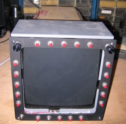

MPCD Prototype
Figure 1
Well, here we are back at the MPCD, I have blogged twice before about this unit. First, where I got the pin-out for  MPCD and got it working. Then I had to rewire the cable. Well, now it's the third time..
The Interface ( switches ) are arranged in 5 x 5 matrix, so I could just build a matrix, add diodes, and write a scan module. Nah, that's too much work! If you remember my CP-1252/ASN-128 CDU (Figure 2).  I interfaced the CDU  with an Arduino and the PS/2 interface. Good, this will simplify both my hardware development and software, REUSE the PS2 Keyboard code base. This gives me my code-base for both the CDU and the IOP.
The Set Up. Dah rules, there are just a few:
  • Each key switch is connected to the PS2 Keyboard controller an SPST, normally off, momentary push, non-locking switch.
  • Each key switch shall be referenced by its position on the bezel.
  • Each key switch shall be labeled in the code base as KeySwitch.[letter] ie the  busted switch on the bottom as KeySwitch.Q
  • Each key switch shall be lit by an internal LED.
  • Each LED shall be known as KeySwitchLED[letter] the same switch as before would now be KeySwitchLED.Q
  • For reference, all the switches and LEDs shall have two (2) contacts each. My notation ::= is defined as
    • Switch Common ::=  1
    • Switch Active Leg ::=  2
    • LED common ::= 3
    • LED anode ::= 4
Since there are 20 keys, I only need to use three eight-bit, I2C, I/O expanders, the Texas Instruments PCF8574A.Now that means I have 4 extra pins on expander #3. I have a chart (Figure 3) consisting of ASCII output, expander, i/o pin. It is color codedto help keep it straight.

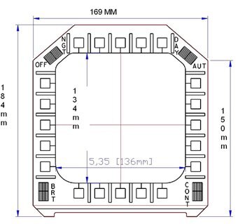

Current Style Bezel
Figure 4
