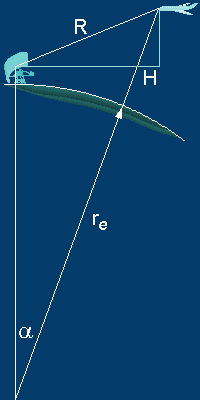

  • Slant Range Calculation. ::= 1.25 · (√aircraft alt + √ radios antenna height above sea level)
this will be changed to:
R2 = re2 + (re + H)2 - 2re(re + H) · cos α ( where re ::= earth radius )
Under the assumption that the earth is a sphere the section of the circumference of the earth can be calculated with the help of a simple ratio from the complete circumference of the earth from the angle α
360° · Rtopogr. = α · 2π re
information and image cite: radar tutorial -Slant Range
