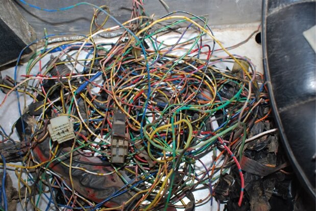

imageWhat have I done? It seems that I have created a monster.

    phoenixcomm over 8 years ago in reply to DAB +1
    DAB over 8 years ago in reply to phoenixcomm
    Yep, that is what it looked like at times.
  • phoenixcomm
    Brings back memories when I had to interface avionics boxes to the simulator.
    Cables, Cables everywhere.
