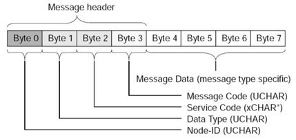

Enter CANaerospace (Open Source) has been codified by ARINC 825, both Airbus and Boeing have adopted this technology on their newer models.  Such as A380 for entertainment system only. On July 30, 2019, the U.S. Homeland Security Cybersecurity and Infrastructure Security Agency (CISA) released ICS-ALERT-19-211-01 about the hackability of CAN Bus avionics networks in civilian aircraft. imageimage
As you can see it uses an ISO 7 layer model. The message is comprised of Five (5) fields: Node-ID, Data-Type, Service Code and Message Data. Theses fields are well defined here "Interface specification for airborne CAN applications V1.7".imageimage
Data representation Endianness is Big Endian which is used on M68K, SPARC, and most Internet Protocols while Little Endian is mostly found on x86 hardware and some Arm processors.

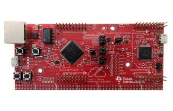

Next, I have will to build an Ethernet-CAN Gateway-Controller. This most likely will be a TI launchpad 32-bit board with a built-in RJ-45 Ethernet connector, there is also a CAN controller but no transceiver. DUH, but it does have an SPI interface, so it looks like I will just have to use the CAN module that I have used before.
CAN ControllerArduino MegaTI Tiva TM4C1294
