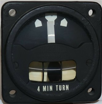

Indicator, Slip and Turn
Manufacture:R.C. Allen
Part Number: M3520-4
Connector:
Connector Mate:MS3106-14S-2S
Pin A: +28v
Pin B: -28v
Pin C: +5v (lighting)
Pin D: -5V
Pin E: Spare
Note: This unit will have to be modified as the indicator is gyroscopically driven.  most likely this is a candidate for a servo.
