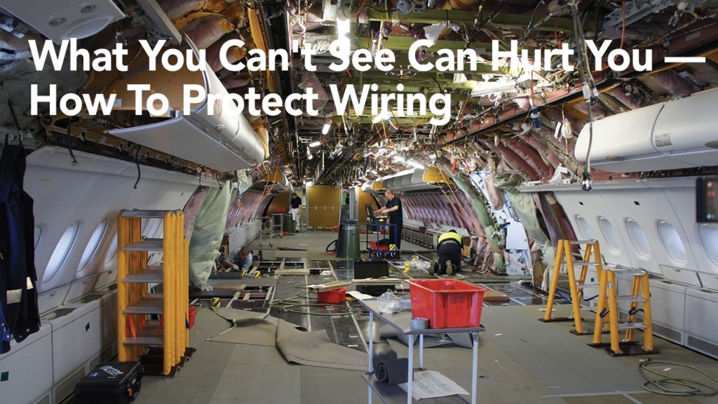

Aircraft wiring is critical to safe flight as it supplies data/signals to critical avionics/flight equipment. The FAA has recognized the importance of wiring and created regulations for the Electrical Wiring Interconnection System (EWIS). Two key factors have contributed to this increased focus: the aircraft fleet is aging and repeated flights can affect the integrity of the wiring and advances in avionics means that more wiring harnesses are being loaded into old and new equipment.
imagen July 17, 1996, the center fuel tank of TWA Flight 800 exploded just 12 minutes after departing JFK International Airport. It crashed into the Atlantic Ocean with total loss of life.
In response, the FAA created the "Aging Transport Systems Rulemaking Advisory Committee" (ATSRAC) composed of airlines, OEMs, and regulators. The ATSRAC inspected 81 in-service aircraft and found 3,372 wiring/electrical distribution discrepancies that included deteriorated wiring, corrosion, wire chafing, wire arcing, improper bend radius, improper installation and repairs as well as contamination by metal shavings, dust, and flammable fluids.
Over time, wiring insulation becomes brittle and prone to cracking, which exposes the conductor and creates the potential for hazardous electrical system malfunctions, such as a short circuit or airframe arc. Rubbing and chafing can accelerate this and then condensation, fluid containment, metal shavings, dust and debris can bridge the gap between a wire conductor and an adjacent metal structure.
What is disturbing from the ATSRAC study is that all 81 inspected aircraft were airworthy, in-service and had received numerous prior inspections and progressive/preventive maintenance. Until this review, wiring had rarely received special maintenance or inspections, even though it was widely known that wiring discrepancies or failures caused delays, unscheduled landings, IFE system problems, and both non-fatal and fatal accidents.
