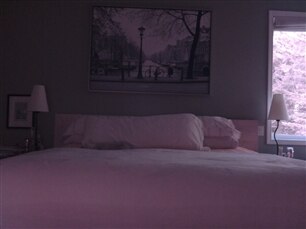

So I set up the Raspberry Pi Noir camera with motion sensor for testing - throughout the evening I could use the website to see CharlieKat sleeping on the bed, and Linus up there later.
That little dark blob at the left side of the long white pillow is CharlieKat image

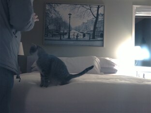

We left a little salt-lamp on like kind of a night light, and that seemed to be just enough light - throughout the night the Pi_Noir camera was able to snap pictures, mostly of CharlieKat on the bed like that, occasionally with him looking at strange contraption at the other side of the room image
Here's a picture of when I got home - that's me trying to save the webcam picture on my cell phone image
Because the PiNoir doesn't have an IR filter, the regular pictures appear a little on the purplish side, which is perfectly fine for this purpose.
The log file also recorded motion events properly, but needs to be adjusted to be a bit more sensitive.
