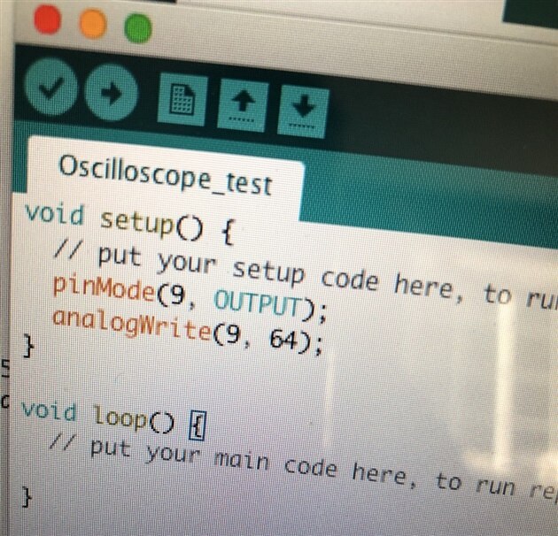

So I pulled out an extra Arduino Uno I have here to get the very first basic pattern to test: the Blink sketch.
(I don't recall if I had to speed up the blinking to get this result)
Turns out that gives a nice easy square wave (? is that the term?) to look at. Yay it works!
Then I tried with AnalogWrite, as James did in his video, and all I got was muckymuck garbage to look at. hmm... why?
I gave up that evening as it was getting late, but later realized it was likely because I was using pin D13 which has the built-in LED on it. I specifically used it so I could see the LED at the same time as the scope result, but I think it was affecting the output voltage levels. Yes, I did press the auto-set button a few times without luck.
So today I changed the sketch to use pin 9, and success! I can now see how PWM looks:

    baldengineer over 4 years ago +2
    Heads up, pin 13 does NOT support analogWrite(). If you go peer inside of the function's code (line 276), you'll find that on non-PWM pins, it just turns the pin ON or OFF based on the value you passed…

    > haven't had any luck trying to scope fading with analogWrite You should see the high part of the signal go narrower and broader, when the analogWrite() vallue changes. The PWM frequency stays the same…

    > I haven't had any luck trying to scope fading with analogWrite, and I don't know if that's a limitation with the scope or with the user.
    It depends on how fast you change the analogWrite() value in code. If you put the analogWrite into a loop, across multiple triggers you should see the pulse width changing.
    for (int x=0; x<255; x++) {
      analogWrite(9,x);
      delay(1); // see difference with and without
    With the 1 millisecond delay, you'll never see the PWM change on the screen (in a single acquisition.) Without, you *might* catch it. Either way, you'll see the pulse width change as the scope re-triggers.

  • ntewinkel
    ntewinkel over 4 years ago in reply to baldengineer
    > "Heads up, pin 13 does NOT support analogWrite()"
    Aaahhhhh. ok that makes a lot more sense now - I wondered why the LED would make that big a difference. I forgot about that detail of not all pins supporting PWM.
    Thanks for the clarification Slight smile
    edit: you know, the funny thing is that for pin 9 I specifically verified that it was capable of PWM (checking for the ~ as you mentioned), but I totally failed to think of looking at D13 for that detail Face palm
