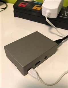

Here's a picture of my Raspberry Pi mini-server. It's using a Pi 3B (+, I think?).
I did also buy an aluminum alloy case off Amazon recently, for my Raspberry Pi 4 - it was on sale for only $15CAD, so I thought that might be a good solid option for silent heat dissipation as well as keeping it safe and looking like a good little server rather than some random PCB sitting there image
So I might replicate my current setup onto the Pi4 to see how things look there.

Last month I ordered a heatsink case off AliExpress to see if that would make a difference. At about $11 Canadian dollars, it was an inexpensive thing to try out, plus the case looks a bit more professional.
And it seems to help a fair bit: I installed it earlier today, and the temperature now stays steady at around 44ºC, compared to recent temperatures of around 50ºC in the modified plastic case which was standing on edge. And considering the original temperatures were running around 56º, that's a significant improvement.
The metal case feels quite warm to the touch, so it seems to be moving the heat from the board out well enough.
Also now it no longer seems to matter how the case is set up - propping it on edge doesn't seem to make it any cooler. I don't intend to run it hard, so this case will be perfect to keep it at a reasonable temperature.
I suppose if necessary, an additional heatsink could be applied.
