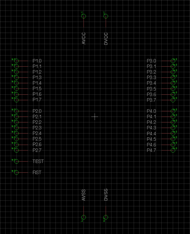

So now we've completed all the preparatory work to make things easier we'll go ahead and start creating the symbol. First things first lets go ahead and put down some pins:
PIN 'P1.0'
Now click 8 times while placing these in a vertical row 0.1 inch apart downwards in the upper left left quadrant of the window.
PIN 'P2.0'
Repeat as above but placing these in the lower left quadrant of the window.
PIN R180 'P3.0'
Repeat as above but placing these in the upper right quadrant of the window.
PIN R180 'P4.0'
Repeat as above but placing these in the lower right quadrant of the window.
PIN R270 'AVCC'
Place this at the top of the window just to the left of the centre line.
PIN R90 'AVSS'
Place this at the bottom of the window just to the left of the centre line.
PIN R270 'DVCC'
Place this at the top of the window just to the right of the centre line.
PIN R90 'DVSS'
Place this at the bottom of the window just to the right of the centre line.
Finally place two input pins in the bottom left quadrant.
PIN 'TEST'
Click to place the pin.
PIN 'RST'
We named the ports in the way we did above for two reasons; Firstly, so we have a guide for when we copy/paste in the name strings from the text editor. If they are already having the right basic name it makes it easier to see if something is wrong or which you need to paste in next. The second reason, if you just want to get the symbol done quickly, in this instance this would suffice from a pin naming perspective and you could move on to the following sections and add the component body and tidy up the pin placement quickly so you could get on with your schematics. We're going to complete this symbol properly here though so we shall not be cutting any corners today.
Now we'll do a little tidying up of the pins before we move on to the drawing the symbol body. Using the group and move commands, move the P2.x pins to be vertically below the P1.x pins with a 0.2 inch gap between the two groups. Repeat for P3.x and P4.x on the other side. Now move P1/2.x to be roughly centred vertically and 1.2 inches to the left of centre. Repeat for P3/4.x, making these in line with P1/2.x but 1.2 inches right of centre. Now move the TEST and RST pins 0.2 inches below P2.7 with a 0.2 inch gap between them. Finally move AVCC/DVCC to 0.2 inches either side of the centre line and 0.6 inches above the line of P1/3.0 and move AVSS/DVSS to 0.2 inches either side of the centre line and 0.6 inches below the line of RST.
Okay, I appreciate that was all a little long to read and follow along with, hopefully we've got past the most tedious bit now. Here is what you should have at this point:

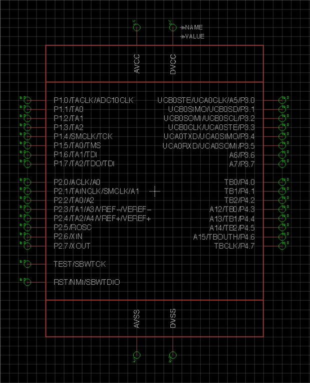

3.5. Updating the pin names from the text file
Now we'll tile our text editor on the left and our library editor on the right and using the NAME command we'll copy and paste the long name strings from the text file into the library part one at a time.
NAME
Now click the P1.0 pin to edit its value and copy the string from the text file. Rinse and repeat until all the pins have been named. It may seem long winded but once you get into the swing of it it's rather quick, much better than typing all those names in manually. Once completed you should have something that looks like the following:

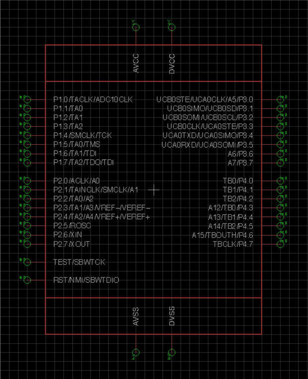

3.7. Drawing the symbol body
The body of the symbol is made up of lines draw on the Symbols layer.
CHANGE LAYER Symbols; LINE
Now draw a rectangle such that it touches the pins all the way round. My preference is also to draw horizontal lines to segregate the power and ground sections from the main body. In more complicated symbols this concept can be extended to segregate functional segments of a symbol.
One more thing to do before we move to the final part is to ensure the symbol is properly centred. Quickly count how many squares above, below, left, and right of the origin there are. If there is an offset then group the entire symbol and move it so that is it centred correctly on the origin. Once completed you should have something similar to the following:
3.7. Adding text information
Finally, just as we did previously for the package we need to add some textual information to the symbol. There are two built in attributes which we can access via placing TEXT fields containing >NAME on the Names layer and >VALUE on the Values layer.
CHANGE LAYER Names; TEXT '>NAME'
Then click to place this 0.2 inches above the top of they symbol body and 0.1 inches to the right of the DVCC pin.
CHANGE LAYER Values; TEXT '>VALUE'
Again click to place this, this time 0.1 inches below the >NAME text.
After you've done this you should have the following:

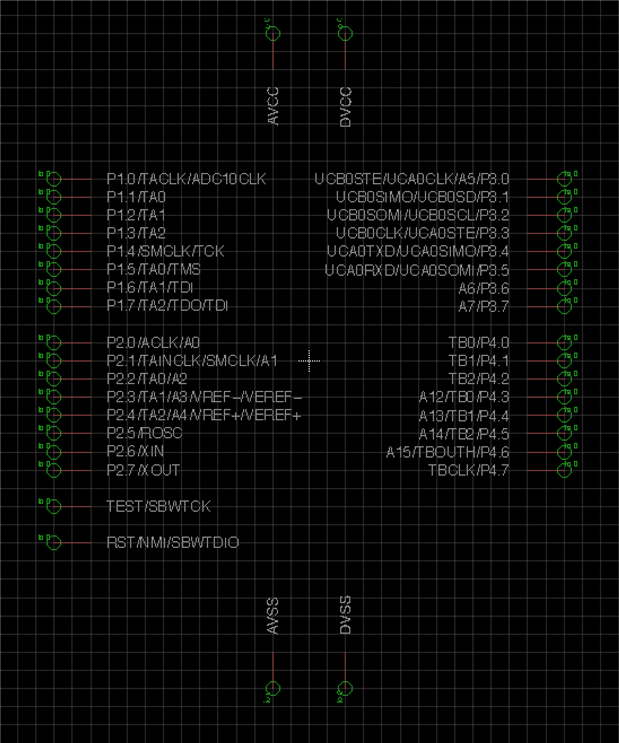

4. The Completed Symbol
The result of everything above enables the creation of a clear and usable symbol with relative ease. The video below shows how long it took me to create a complete and accurate symbol for a Texas Instruments MSP430F22x2 microcontroller. In the video, to help clarity and to show what is being done, I don't use any keyboard shortcuts or ULP to accelerate anything and as a result this symbol takes longer to create than it would when using shortcuts and ULP. I'll cover how to speed the process up even further using these methods in a future blog article.
