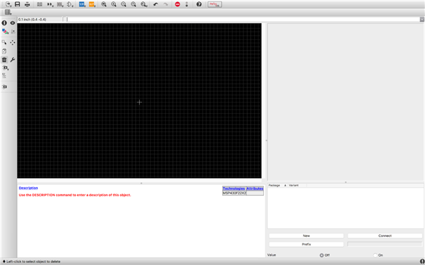

3.2. Naming the device
For this initial version of the device we'll just call it MSP430F22x2, however in a future tutorial when we learn about package variants and technologies then we will rename this device to all more sophisticated device naming to take place. For now we'll just create the device in the same way we did for the package and symbol in the previous tutorials.
EDIT MSP430F22X2.dev
After confirming that you wish to create a new device you will be presented with an empty device window as shown below:

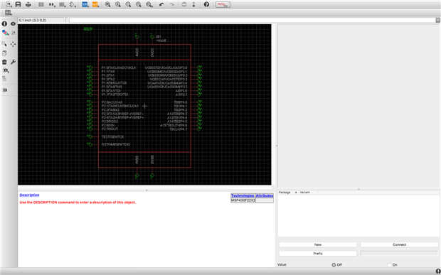

3.3. Adding the symbol
The first thing we need to do is add our symbol to the device.
ADD 'MSP430F22X2'
Click on the origin of the symbol to place the symbol centrally in the window.
Alternatively we can click on the 'Add" button on the toolbar and select our symbol in the resulting dialog.

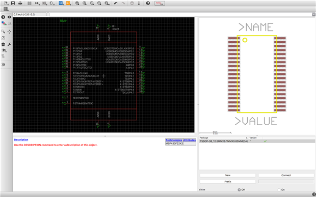

After adding the symbol we have the resulting device:
3.4. Adding the package
Now we want to also add our package to the device.
PACKAGE 'TSSOP-38_12.5MMX6.1MMX0.65MM(DA)'
This will automatically add the package with the default variant name into the device.
Alternatively we can click on the 'New' button in the bottom right quadrant of the device window and select our package in the resulting dialog.
After adding the package we have the resulting device:

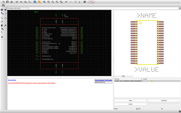

3.5. Mapping the symbol pins to the package pads
This is the longest part of the process and the place where errors could occur so it is important not to rush and to check as you are going along that you have mapped everything correctly and to double check again at the end to ensure you haven't missed anything.
Start by double clicking on the package name in the list on the right hand side or use the following command:
CONNECT
This will open up the pin mapping dialog box. There are three columns to this dialog, the left hand column lists all the available symbol pins, the middle column lists all the package pads and the final right hand column list the currently connected pins and pads.
Now by referencing the datasheet, select each pin in turn in the left hand column and for each of these select the appropriate pad in the middle column then click the 'Connect' button. If more than one pad is associated with a pin (which is not the case in our current example) then you can select multiple pads by holding down Ctrl (Cmd on macOS) and clicking on all the pads required before clicking connect. If you have missed any pads from a connection, then select the connection in the right hand column, select the pads as previously described and then click the 'Append' button. If you've made a mistake with a connection then select it in the right hand column and click on 'Disconnect' to delete the connection.
After working through the pin mapping we have the resulting device:
Notice the green tick which has appeared next to the package to indicate that it has been fully connected and is ready to use.

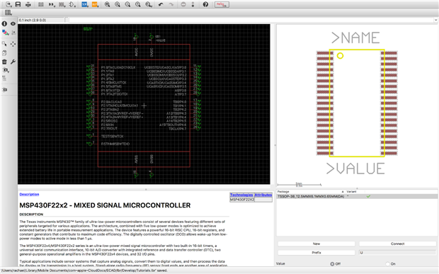

3.7. Updating the device description
Having a useful description for a device can make searching your libraries for a suitable part far easier. The description for the device must be written in HTML but don't worry, you just need to know a few bits and pieces and have a template and then you can copy and paste from the device datasheet to create your description. Here is a basic template to make a start with a simple description:
DEVICE AND BRIEF TITLE
DESCRIPTION
The description goes here.....
Add as many paragraphs as you need....
Further information is available in the datasheet for the part which can be found here.
So now we'll go ahead and create a basic description for our part. We start by clicking on the "Description" link in the bottom left quadrant of our device window or issuing the following command:
DESCRIPTION
Now we copy our template into the bottom half of the resulting dialog and update it with useful information from the datasheet. Here is a short description as an example:
MSP430F22x2 - MIXED SIGNAL MICROCONTROLLER
DESCRIPTION
The Texas Instruments MSP430™ family of ultra-low-power microcontrollers consist of several devices featuring different sets of peripherals targeted for various applications. The architecture, combined with five low-power modes is optimized to achieve extended battery life in portable measurement applications. The device features a powerful 16-bit RISC CPU, 16-bit registers, and constant generators that contribute to maximum code efficiency. The digitally controlled oscillator (DCO) allows wake-up from low-power modes to active mode in less than 1 µs.
The MSP430F22x4/MSP430F22x2 series is an ultra-low-power mixed signal microcontroller with two built-in 16-bit timers, a universal serial communication interface, 10-bit A/D converter with integrated reference and data transfer controller (DTC), two general-purpose operational amplifiers in the MSP430F22x4 devices, and 32 I/O pins.
Typical applications include sensor systems that capture analog signals, convert them to digital values, and then process the data for display or for transmission to a host system. Stand-alone radio-frequency (RF) sensor front ends are another area of application.
Once you have pressed 'OK' the description will be shown in the main device window as follows:
