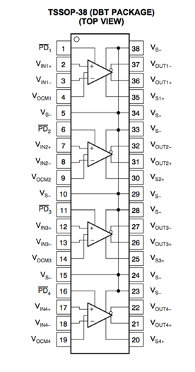

The device is organised as per the following:
As you can see there are four identical amplifier stages. Each has a differential input, a common mode input voltage, a power down input, a differential output and a positive supply rail. All four amplifiers in the package share the same common negative power rail.
2.1.2. Pinout
For the amplifier sections the pinouts are:
Pin NameChannel 1Channel 2Channel 3Channel 4
PD161116
Vin+271217
Vin-381318
Vocm491419
Vout+36312621
Vout-37322722
Vs+35302520
For the common negative input rail the pinout is:
Pin NamePin Numbers
Vs-5, 10, 15, 23, 24, 28, 29, 33, 34, 38

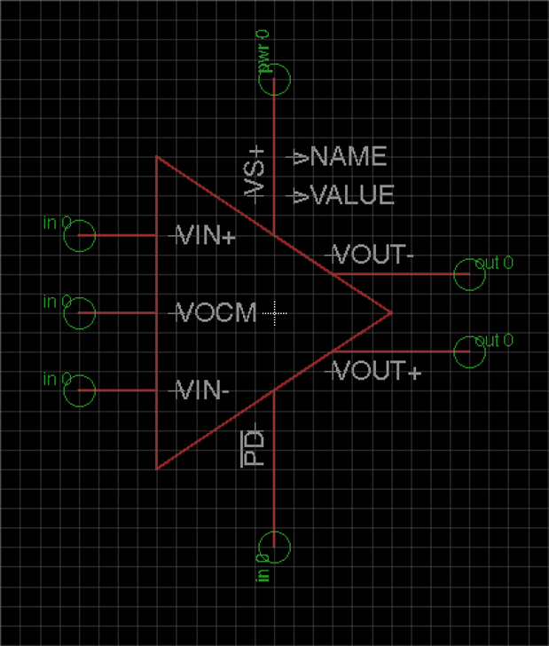

So we can see from the above that there are two distinct functional groups. There are the op-amp channels in one group and the common negative rail in the other. What we need to do is create a single symbol to represent each of these groups. This is no different from how we've created symbols before so I won't redo this again, I will just show each of the symbols as I have drawn them in my library.
The first symbol is the main op-amp channel symbol:

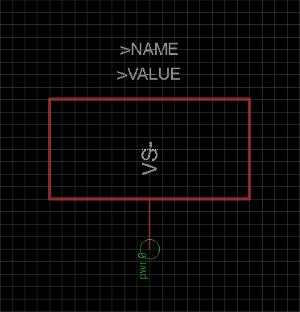

Finally we need a symbol for the common Vs- rail:

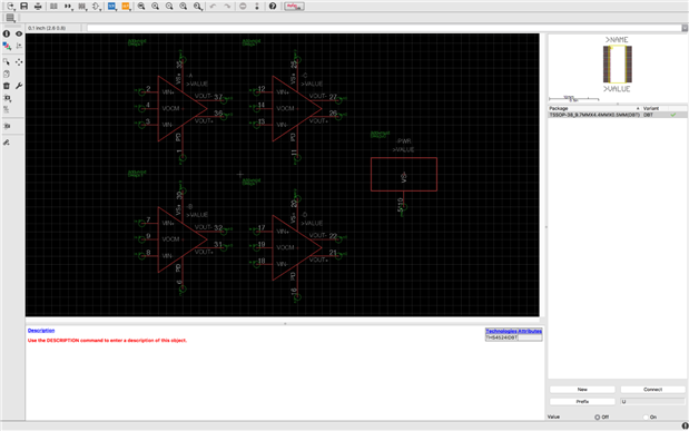

We now start to create the device exactly the same way as we did in Part 3. This time however, instead of just adding a single symbol to the device we add four of the op-amp channel symbols and one common rail symbol.
In the schematic when we place the parts we want the symbols to have meaningful reference designators so we can easily differentiate between them, e.g. U1-A, U1-B, U1-C, U1-D, U1-PWR. We do this by using the NAME command and giving each symbol in the device view a corresponding suffix name. In this case we want them to be called -A, -B, -C, -D, and -PWR.

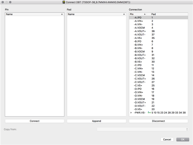

Now, we can go ahead and map the pins exactly as we did previously. When you look in the pin mapping dialog, you will see that the names we chose in the step above are prefixed to the pin names so you can see to which symbol they belong. Once you've mapped all the pins you should have something which looks like the following:
Now there is one final thing we need to do is ensure that the symbols are added correctly. You will see that next to each symbol there are two properties. AddLevel and SwapLevel. We'll delve into these further in a subsequent tutorial so for now I will tell you that we'll be setting the properties on the -PWR symbol to AddLevel=must and SwapLevel=0 and for the op-amp symbols -A/B/C/D we will set the properties to AddLevel=next and SwapLevel=1. Once these are set the library view will look like the following:

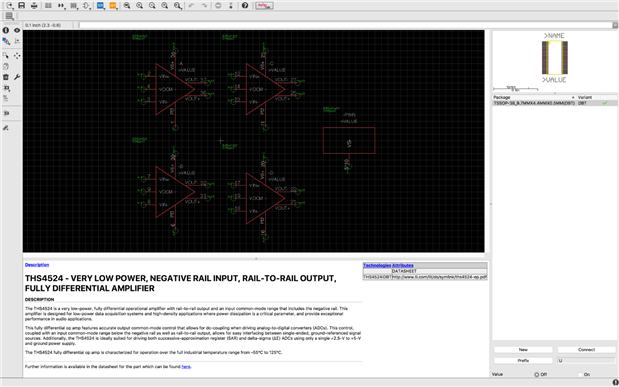

We'll finish off by adding any attributes we need and updating the description for the device as we did previously.
3. The finished multi-symbol device
Once it's all done you should see something like the following:
You'll see in this example I have added an attribute called DATASHEET. This is something I add to all my parts. I have a ULP which adds a right click context menu entry 'View Datasheet' which uses this attribute and launches the datasheet in the system default browser which is exceedingly useful when you need to get to a datasheet for a part quickly. You can find this ULP and several others over on my EAGLE ULP Utilities Library blog page. I'll be covering adding attributes to parts in the next instalment of this EAGLE tutorial series.
