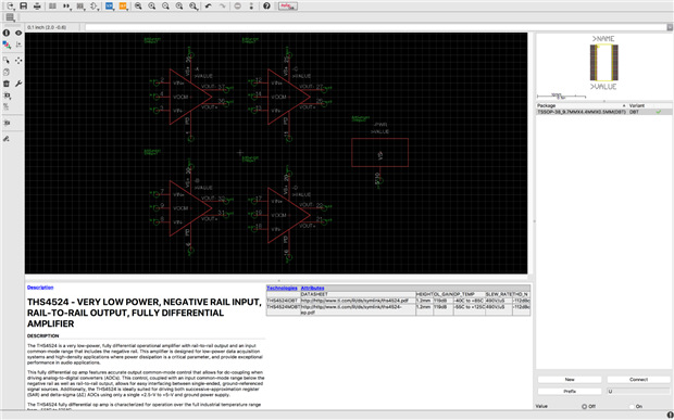

2. The purpose of attributes within EAGLE libraries
Attributes are used to store additional information associated with a part. The attributes defined may be different depending on the package variant and the values for each attribute are unique for each technology specified within a package variant. You may wonder why you might want to specify different attributes depending on the package variant and that is a good question, intuitively you wouldn't think there was any relevant information which you would want to capture which was different between different packages, but actually it can be useful. For example, the BGA Router feature in EAGLE v8 adds additional attributes (to the device in the board) to configure its operation for a particular device. You wouldn't want these additional attributes being associated with non-BGA packages.
So what sorts of things might we want to capture in attributes associated with a particular device?
I gave one example previously which was a link to a data sheet for a part. You could also store information relating to vendors and vendor part numbers, electrical parameters such as voltage, current, tolerance, etc, the package height, temperature range, and of course the value. For the purposes of this blog I will extend the THS4524 we created in the previous article to include some additional attributes.
The previous part was actually available in two versions, the standard version with an operating temperature of -40C to +85C and the extended temperature version which operated from -55C to +125C. The first thing I have done is changed the name of the part to allow the specification of different technologies for the two variants. In this case I added an I technology for the standard part and an M technology for the extended temperature range part. In the following section I will show how I added attributes for the data sheet, height, operating temperature, open loop gain, slew rate, and THD+N for these two parts.
AttributeStandardExtended
DATASHEEThttp://http://www.ti.com/lit/ds/symlink/ths4524.pdfhttp://www.ti.com/lit/ds/symlink/ths4524-ep.pdf
HEIGHT1.2mm1.2mm
OP_TEMP-40C to +85C-55C to +125C
OL_GAIN119dB119dB
SLEW_RATE490V/uS490V/uS
THD_N-112dBc-112dBc

However, before you can create any attributes you must first open up the device and select the package variant you would like to add attributes to and specify which technology they refer to with the TECHNOLOGY command.
TECHNOLOGY myTech
In order to create all the attributes given in the previous section for our example device, one the device is opened up (there is only one package variant) then you can either specify them in the GUI editor or issue the following commands to add them programatically:
TECHNOLOGY I; ATTRIBUTE DATASHEET 'http://http//www.ti.com/lit/ds/symlink/ths4524.pdf';
TECHNOLOGY M; ATTRIBUTE DATASHEET 'http://http//www.ti.com/lit/ds/symlink/ths4524-ep.pdf';
TECHNOLOGY I; ATTRIBUTE HEIGHT '1.2mm' CONSTANT;
TECHNOLOGY M; ATTRIBUTE HEIGHT '1.2mm' CONSTANT;
TECHNOLOGY I; ATTRIBUTE OP_TEMP '-40C to +85C' CONSTANT;
TECHNOLOGY M; ATTRIBUTE OP_TEMP '-55C to +125C' CONSTANT;
TECHNOLOGY I; ATTRIBUTE OL_GAIN '119dB' CONSTANT;
TECHNOLOGY M; ATTRIBUTE OL_GAIN '119dB' CONSTANT;
TECHNOLOGY I; ATTRIBUTE SLEW_RATE '490V/uS' CONSTANT;
TECHNOLOGY M; ATTRIBUTE SLEW_RATE '490V/uS' CONSTANT;
TECHNOLOGY I; ATTRIBUTE THD_N '-112dBc' CONSTANT;
TECHNOLOGY M; ATTRIBUTE THD_N '-112dBc' CONSTANT;
It's often much quicker to write a script to create attributes as you can utilise copy/paste and rerun the same script for different package variants. When you create lots of libraries, especially if you want to add technologies to specify value ranges and force the values in the attributes, you'll come to find the EAGLE standard GUI for adding these to be too cumbersome and slow.

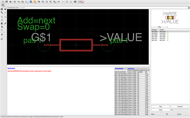

4. Using the VALUE attribute with technologies
Sometimes you want to specify a range of available values for people to choose from in the schematic. For example if we take simple resistors, you might wish to provide users with an easy way to select values from the E24 standard value range. This range contains 24 standard values per decade, 1.0, 1.1, 1.2, 1.3, 1.5, 1.6, 1.8, 2.0, 2.2, 2.4, 2.7, 3.0, 3.3, 3.6, 3.9, 4.2, 4.7, 5.1, 5.6, 6.2, 6.8, 7.5, 8.2, 9.1. For each decade these standard values get multiplied by 10, 100, 1K, 10K, 100K, 1M, 10M, etc. In order to make this useful we can use technologies to allow us to specify and switch between values in this list using the TECHNOLOGY command in the schematic or board.

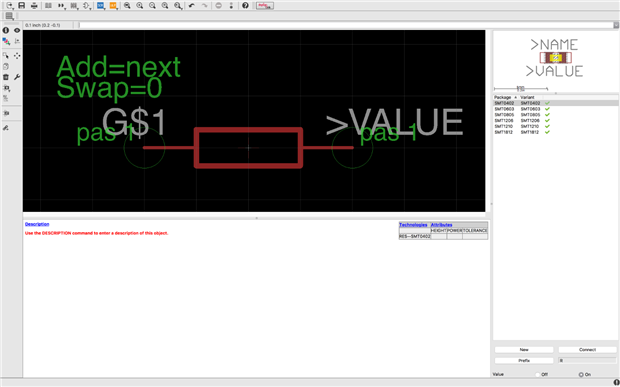

Lets work through how to do this, so we'll start with a simple library part for resistors. The device is called RES-*-? and is a simple resistor symbol with package variants available for standard 0402, 0603, 0805, 1206, 1210, and 1812 packages.
We'll start with the 0402 package variant selected. The first thing we need to do is add an attribute to hold the value of the part and override the built in VALUE attribute.
ATTRIBUTE VALUE CONSTANT
Now we need to remove the default technology and create technologies for all the standard values and fill in the attribute values for each entry:
TECHNOLOGY 0R; ATTRIBUTE HEIGHT '0.4mm'; ATTRIBUTE POWER '1/16W'; ATTRIBUTE TOLERANCE 'JUMPER'; ATTRIBUTE VALUE '0R';
TECHNOLOGY 10R; ATTRIBUTE HEIGHT '0.4mm'; ATTRIBUTE POWER '1/16W'; ATTRIBUTE TOLERANCE '1%'; ATTRIBUTE VALUE '10R';

Running the above script will take a few moments. The screen may flash for a few seconds while it's running through adding all the attributes. Once this is complete we can rinse and repeat for each of the other package variants, updating the attributes HEIGHT and POWER as appropriate for each different package size.
Once all the technologies and attributes have been added to the library you should see something similar to the following:
5. Completed attribute examples
The following shows how I quickly created useful attributes and added them to the THS4524 library part in EAGLE.
The following video shows the result of adding a technology driven value system to a resistor library part.
