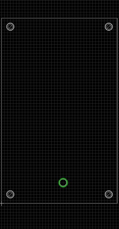

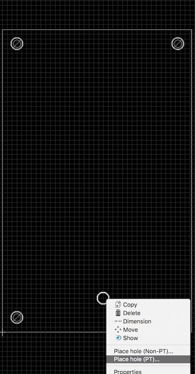

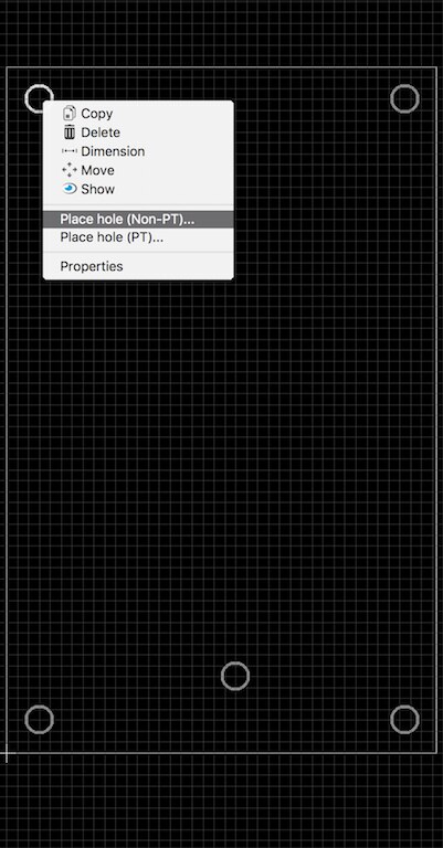

The utility adds two new context menu entries "Place Hole (Non-PT)..." and "Place Hole (PT)..." when you right click on a circle or arc within the board editor. The general use case is that you would import a DXF from the mechanical design to specify all the mechanical parameters, size, shape, fixed component positions, mounting holes etc. Then you would right click on any holes and choose to insert either a plated or a non-plated hole and it would insert a hole of the correct size based on the size of the circle or arc.
2.1.3. Known limitations
NONE.

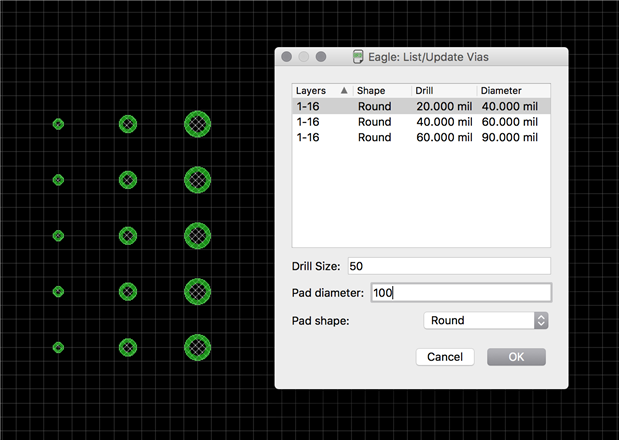

2.2.2. Usage

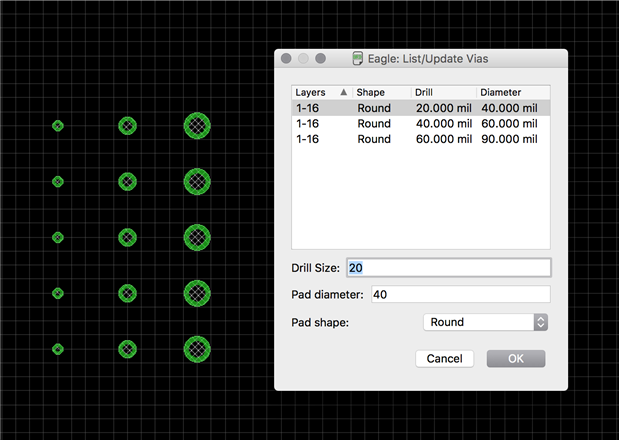

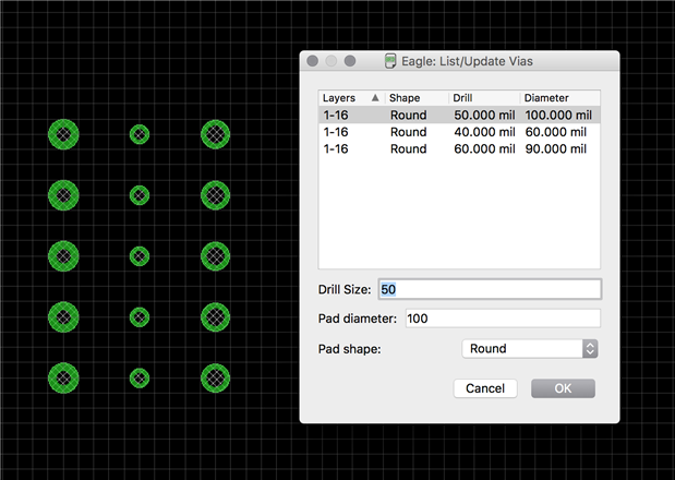

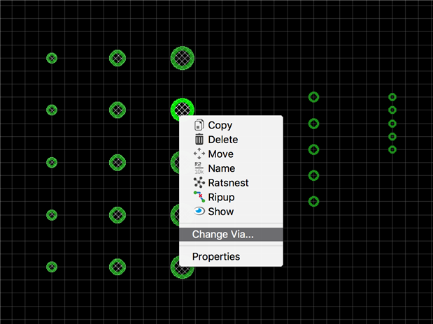

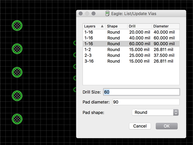

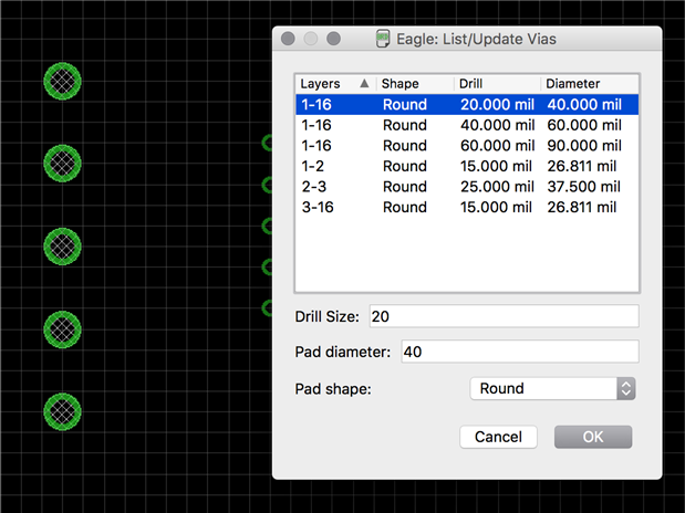

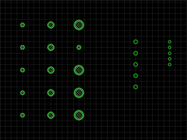

The utility adds a new context menu entry "Change Via..." to allow for the selected via to be changed to match a via style which is selectable from a list of all those already in the design. When launched the current via style for the via is automatically selected. Clicking on alternative existing vias and clicking OK will change the via to match another existing via style. Manually altering the values to define a new style and clicking OK will result in the via being updated to the newly defined style.
Opening the main GUI will present a list of all the different via styles currently available in the design. Select an item from the list and it's parameters can be configured such that the drill size, pad diameter and pad style can be chosen. Clicking OK will update all the vias of that style in the design to the updated style.
2.2.3. Known limitations
  1. The start and finish layers of the via can't be changed. The start and end layers remain unchanged when selecting a pre-defined via style which has different layer specifications.
  2. Whist it will show "auto" in the list of available via styles, to change to auto you need to specify a diameter of 0.
  3. The units it uses are only mils rather than adapting to the currently chosen units.

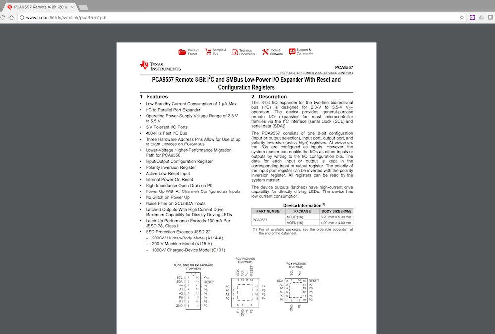

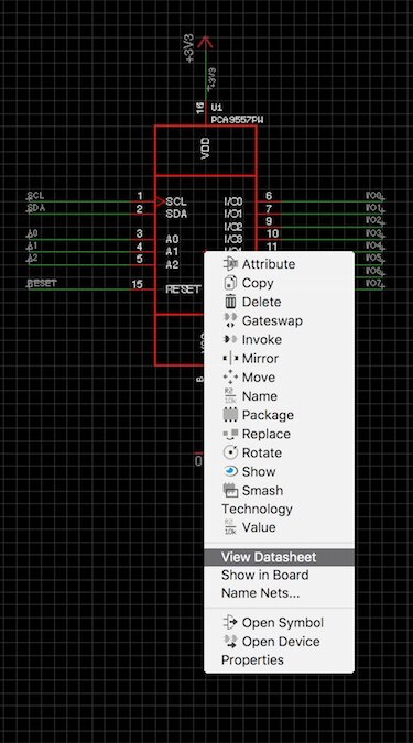

The utility adds a new context menu entry "View Datasheet" when you right click on a component within either the schematics or the board editors. In order for the utility to work the component needs to have an attribute called DATASHEET which contains the URL of the datasheet for the part.
2.4.3. Known limitations
  1. If the DATASHEET attribute does not exist or is empty then the ULP does nothing and ends without any action. A future enhancement will enable the reporting of this to the user.
  2. If the URL specified by DATASHEET is invalid it will currently open the default browser and you will be presented with a 404 error page. A future enhancement will be to test the validity or availability of the supplied URL and only switch to the browser for valid URL's, reporting invalid or unavailable URL's to the user.
  3. Adding the DATASHEET attribute currently requires use of the main attribute editor or the attribute command. A future enhancement will be to allow a datasheet to be added with a specific UI element and the URL will be tested for validity before being written into the DATASHEET attribute.

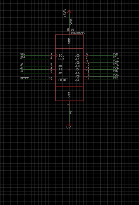

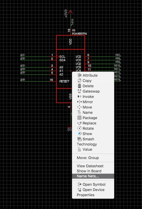

The utility adds a new context menu entry "Name Nets..." when you right click on a component within the schematic editor. If you select this option then the name of any nets connected to pins of the device (except pins of type PWR and SUP) will be changed to match the pin name of the device.
2.6.3. Known limitations
  1. Devices must have any power pins changed to be of type PWR. This can have negative consequences too due to the automatic net connections that this pin type can cause. Without the PWR pin type the nets connecting to global power rails will be renamed and the connectivity of the power rails on the board will be compromised. A future enhancement is planned with the aim to ensure this doesn't happen by automatically detecting pins which connect to nets which contain a global supply connection and not rename these nets.
  2. There is no current way to add a prefix/postfix to net names which are generated so similar devices may accidentally get connected together. A future enhancement is planned which will use attributes to specify prefix/postfix information so these can be set for each device before all the nets are renamed. There will be a UI element created to assist in this as well as additional checks performed and reports to ensure correct renaming.
  3. There is no current way to limit which pins are used for the renaming of nets. A future enhancement is planned which will use attributes to specify which pins to use. There will be a UI element created to assist in this as well as additional checks performed and reports to ensure correct renaming.
  4. Currently this works from a context menu on the components but not directly on nets. A future enhancement will add a "Name Net..." context menu entry when you right click on a net in the schematic or board. This will allow for the choice of which connected component is used to derive the name and to specify (or override) any prefix/postfix as appropriate. There will be a UI element created to assist in this as well as additional checks performed and reports to ensure correct renaming.

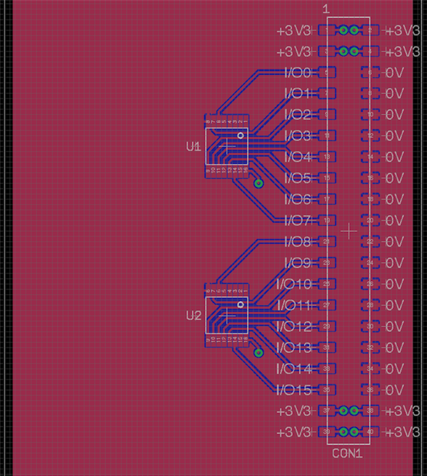

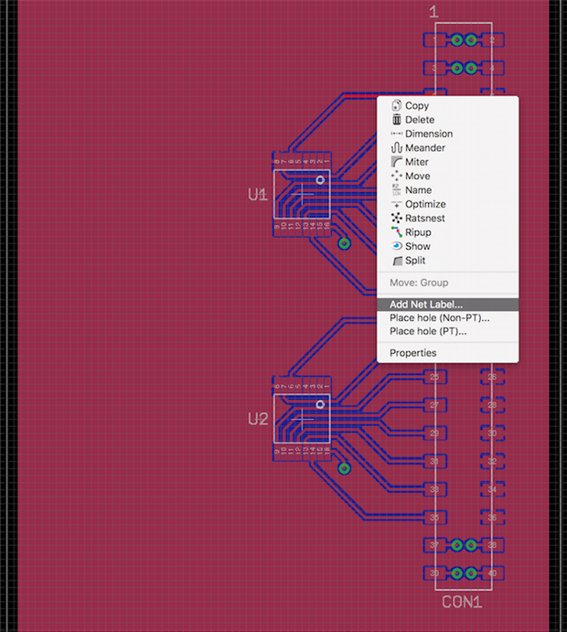

The utility adds a new context menu entry "Add Net Label..." when you right click on a route, airwire or polygon in the board editor. Selecting this option creates a new text label on the currently selected layer. The layer, text size, alignment etc can all be changed in the usual way before clicking to finalise the placement on the board. This facilitates quickly adding silkscreen legends for labelling up connectors for example.
2.7.3. Known limitations
NONE.

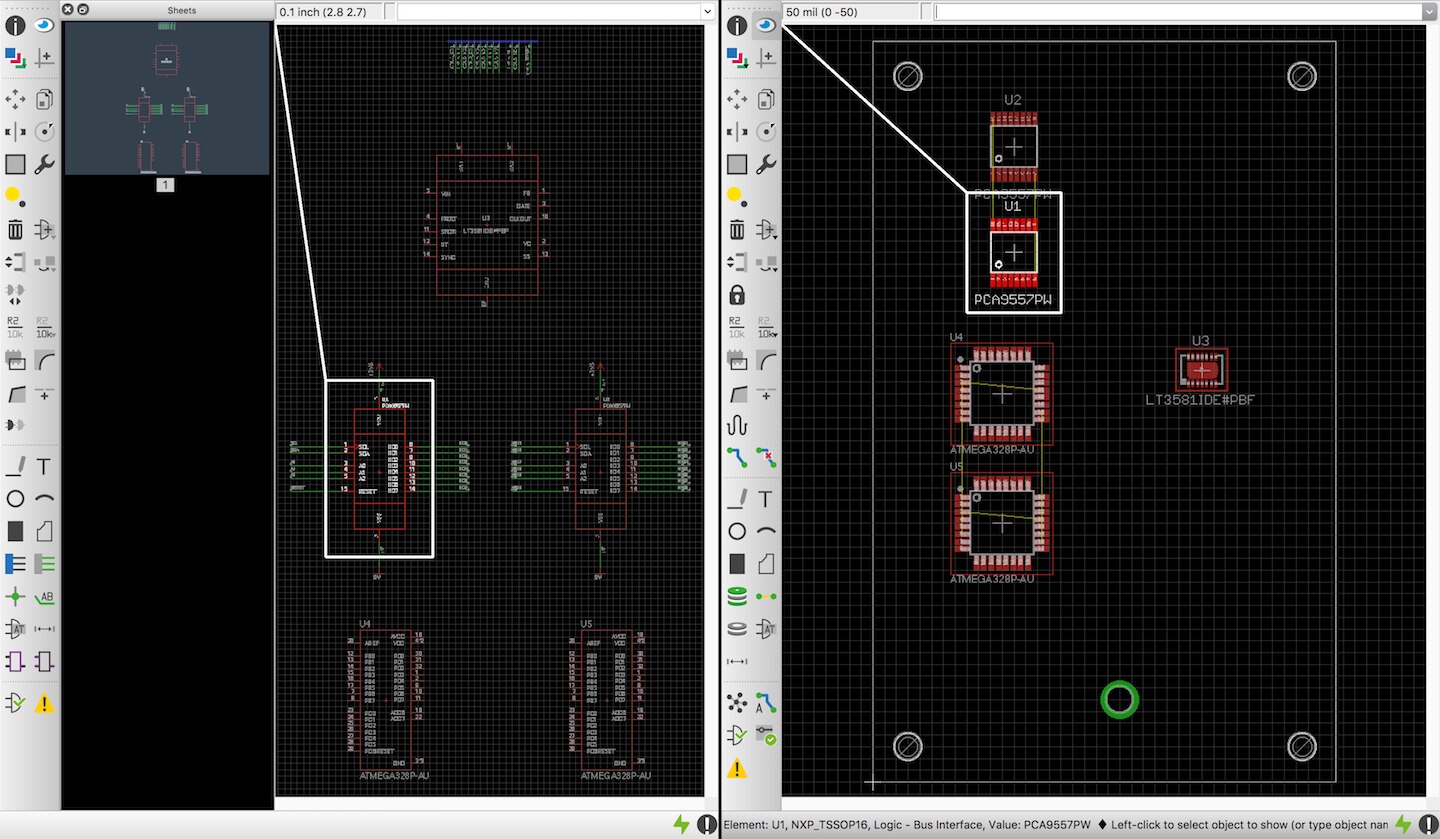

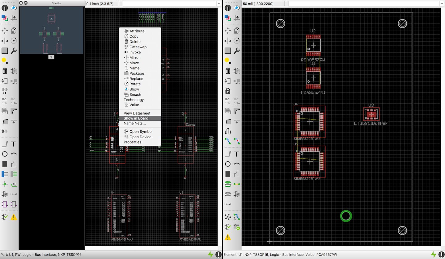

The utility adds a new context menu entry "Show in Board" when you right click on a component within the schematic editor and adds a new context menu entry "Show in Schematic" when you right click on a component within the board editor.
2.8.3. Known limitations
  1. Currently I had to choose between a highlight only and a highlight with a locating box. It currently doesn't offer the choice and does not zoom to the selected so it can be a little hard to navigate around sometimes. A future enhancement will allow configuration of the global behaviour to choose whether or not to have the bounding locating box and also whether or not to zoom to the selected part.

    Additional updates to changeVia:
    Bug fix: Shows the specified pad diameter rather than the post restring diameter so will no longer update vias to the post restring value.
    Feature: Shows "auto" for the pad diameter where appropriate.
    Feature: Shows the Outer/Inner pad diameters post the restring calculations.
    Enhancement: Shows the currently selected via layer range (read only) in the edit area.
  • rachaelp
    rachaelp over 9 years ago
    Added new changeVia command which allows vias within a design to be changed based on existing via styles, either individually or as a group of particular styled vias, existing via styles can be edited and new via styles can be defined.
    This came about following a discussion on the Autodesk EAGLE forums (https://forums.autodesk.com/t5/eagle-forum/via-setting/td-p/7115911) where a member was having trouble changing all the vias in their design as a group. There is an existing ULP shipped with EAGLE (change-via-by-stack) but it turns out this is broken in all kinds of ways, so I decided to add this new implementation to my library. It's still a bit of a work in progress and there are additional features I plan to add over time. I have listed the limitations I know about above, feel free to use it, but please be careful and back up your designs first just in case.
