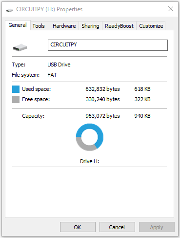

The other issue with this type of application using CircuitPython on the FunHouse is that I don't end up with much file storage space for pictures.  The FunHouse has a 4MB Flash memory, but with CircuitPython loaded there is only about 1 MB left free for applications.
And each 240x240 bmp image takes 169KB, so I can only load a few images.
