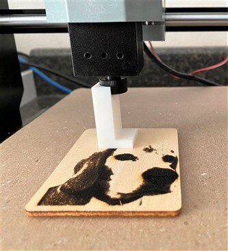

I'm getting ready to try doing some laser cutting with my 5.5W laser that's described in this post: Trying out my laser .
I needed a simple way to get the laser focused on the material I'm cutting and I've found that focusing it visually can be time consuming and also problematic with reflective material.  I decided to use the technique that they used with the Community College C02 lasers which is a mechanical calibration block.  I think this is what most people do.
I first got the laser focused visually as best that I could (minimizing the dot size) and then I engraved lines at varying Z settings and then determined which Z setting gave me the narrowest line.  At that setting I measured the distance from the front of the lens housing to the material.  Then I designed and printed a calibration block that would allow me to set that distance easily.

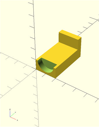

Here is the design in Openscad:

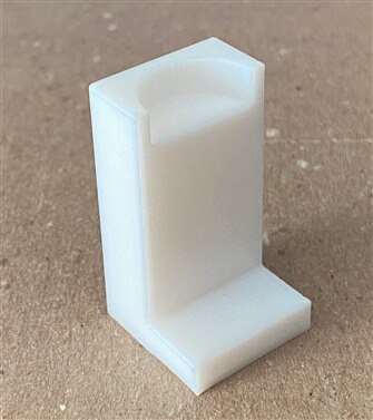

And the printed block:
And example of it in use:

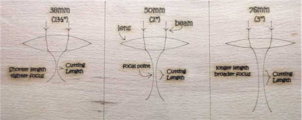

The next step is to determine how much focal depth I have.  I saw an interesting video on YouTube that describes how longer focal length lenses tend to give a larger spot but also a larger depth of focus: Laser Cutter Focus - Measuring Focal Point and Depth of Cut.
Here is a diagram from the video that illustrates the concept:
The focal point that I measured is about 39mm from the front of the lens mount so I expected a rather short focal range (what the diagram refers to as cutting length).

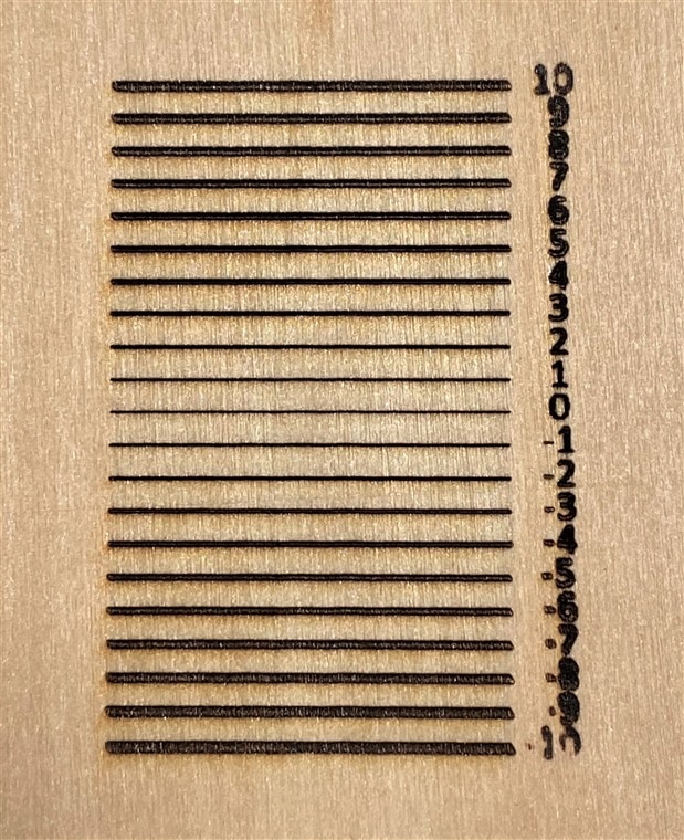

I created a short GCode program so that I could measure the range:

And here's the result. The numbers refer to the distance in millimeters above and below where I set the focal point.  It appears to stay in focus for about 2mm (+/- 1mm).  I guess this implies that if I want to cut something thicker than 2 mm that I want to do multiple passes and adjust the Z height between passes.
Now that I've got the focus calibration done I need to start practicing on different material to figure out speed and power settings for cutting.
