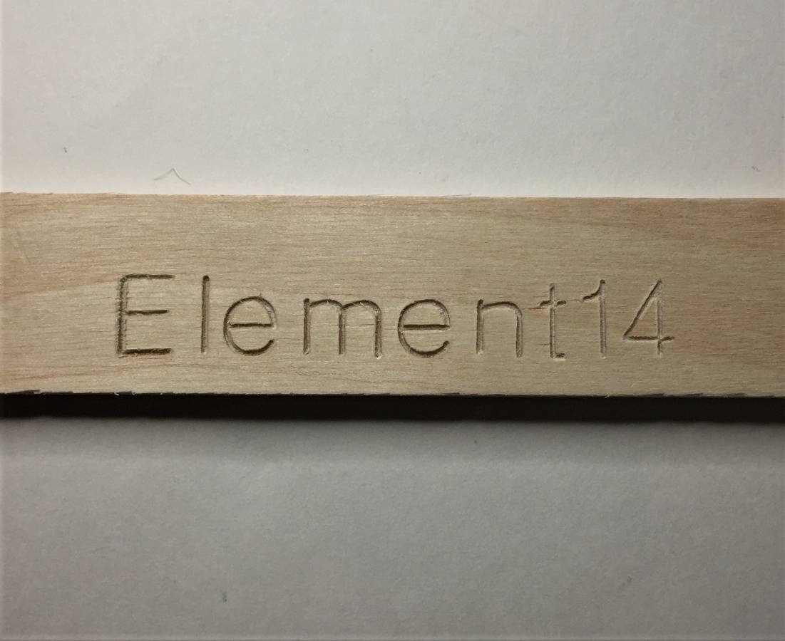

I thought I'd start with some simple engraving to get a feel for spindle speed and feed rate for different tools and materials.  I found a program called F-Engrave by Scorchworks https://www.scorchworks.com/Fengrave/fengrave.html .   It's a pretty basic tool.  It does text engraving and v-carving with text and images.  I bought 1/4" birch veneer plywood slats from a local crafts store to practice.  For simple text I find that I like the look of solid line stick fonts rather than the two line silhouette fonts.  I downloaded a set of CAMBam stick fonts to use (the program uses true type fonts).  For engraving you need to manage the character spacing and depth based on the tool (cutting bit) that you are using, the program doesn't do any auto-adjusting but it does preview the effect of the settings.
This was a simple exercise but it surfaced a few issues.  The most significant one is the surface flatness of what I was engraving.  Part of it is the dimensional variation of the plywood, some of it is the flatness of my extruded bed, and a lot of it is due to the warp from clamping soft wood.  Secondly, I really don't have any feel for these cutting bits (also that I don't have a great selection to choose from).  You can see from the program setup that I'm using a very slow feed rate of 127 mm/min.  I'm using a 20 degree v-bit that came with the kit.  The 775 spindle motor that I have is rated at 3000-9000 RPM (12V-36V).   I'm running it at around 7000 rpm.

And the finished output.  The cut is rough around the edges.  Next try will be to use an endmill instead of the v-bit.
I can see that it is going to take me a few months and a lot of scrap to get somewhat proficient at this.

    That is really impressive work Ralph, well done. I'd be keen to make a similar setup. I've used wood routers before (the 1/4" and 1/2" chuck versions) but never any CNC of wood. The cut is rough around…
  • Fred27
    Fred27 over 7 years ago +6
    That looks good for a first attempt. As you've probably guessed, using an endmill prevents the cut width varying with depth. One thing to be careful of is that endmills do not cut well going straight down…

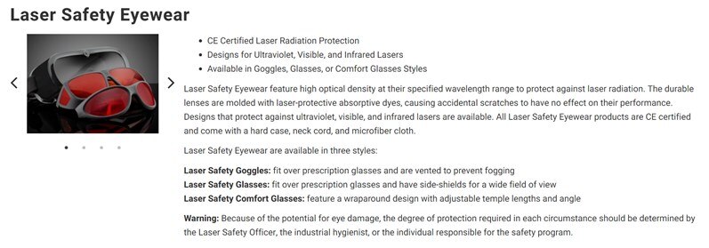

    Regarding safety glasses, I found this website:
    https://www.lia.org/evaluator/od.php
    that helps suggest the light-blocking density level for glasses. In the end I went for type LS02 from Edmund Optics with much higher optical density. It could be overkill, but the price didn't seem unreasonable for such a critical safety item.
    The LS02 is the lowest-cost type they sell, presumably because it only blocks one range of light (there are others for multiple areas of spectrum but at 2-3x the price).
    That LS02 type comes in three frame variants (all priced the same), and the website has the photos mixed : (  Anyway, I've annotated the photo below to show the names of the variants. I accidentally ordered 'comfort glasses' when 'goggles' and 'glasses' look like they will cover more. I cannot tell, I'll wait till it arrives and then try it out. The 'goggles' and 'glasses' can fit over prescription specs or reading glasses and look a lot more comfortable than the 'comfort glasses'.
