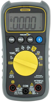

The Fluke 233 uses Bluetooth to transmit data from the meter base to the remote display but I haven't figured out how to capture that data for logging purposes.  In searching for a solution I came across a number of low cost DMMs that use Bluetooth for remote data collection and display.  Apparently this capability has been available on entry level DMMs for a few years now.  All the meters that I found use a mobile app to display the data on a cellphone or tablet using Bluetooth connectivity but I really wanted a way to capture the data on a desktop PC.  I also found a blog post by Tom Igoe where he created an HTML interface for a General Tools TS04 DMM using Web Bluetooth: https://www.tigoe.com/pcomp/code/javascript/1309/ .  This looked like it would do what I wanted so I purchased one of these low cost meters on Amazon for under $25: General Tools TS04 .
General Tools TS04 ToolSmart Bluetooth Connected Digital Multimeter

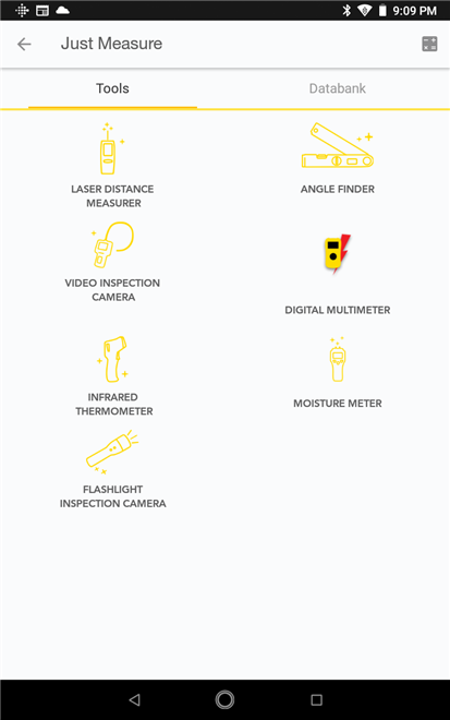

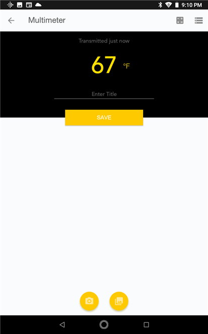

The DMM normally connects using an Android or iOS app so I tried that out first using the ToolSmart app on my Android tablet.  The DMM is one of a family of Bluetooth connected tools from General and the app allows connection and data collection from any of these tools.  Connecting is extremely straightforward - basically just push the Bluetooth button on the DMM and open the app and click on the tool icon and the app handles the pairing.  The DMM came with a thermocouple for measuring temperature and the app identified the measurement mode and displayed the data.  One anomaly that I discovered is that the app requires that you set the units to either Fahrenheit or Celsius and if you change the units on the meter they will not change in the app although the measurement value will change.  Here are a couple of screenshots of the app.
