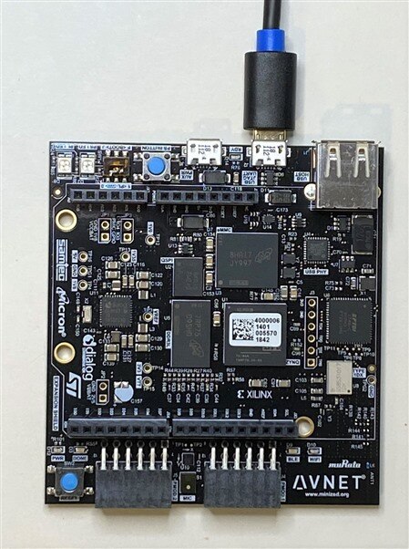

I recently attended an Avnet webinar Learn Embedded Design with the MiniZed (Win a MiniZed for Asking Questions!)  that discussed the MiniZed development board and its design ecosystem.  I also just completed the Path II Programmable training which used the Ultra96 board and the MiniZed seemed like a very capable lower cost alternative for developing less complex designs.  The MiniZed was used in the first Path to Programmable training course.  The MiniZed has been around since 2017 but there has been a lot of recent activity.  Besides the webinar, I noticed that Hackster is doing a 3 hour workshop event on January 30 https://events.hackster.io/mini-but-mighty which is based on a Hackster tutorial that Adam Taylor did on developing a motor control application on the MiniZed using the new Vitis toolset https://www.hackster.io/adam-taylor/mini-but-mighty-the-minized-and-vitis-for-motor-control-9c376b .
I decided to try out the MiniZed and use it as a vehicle to start learning about Vitis.  I'll use Adam Taylor's motor control tutorial to get started.

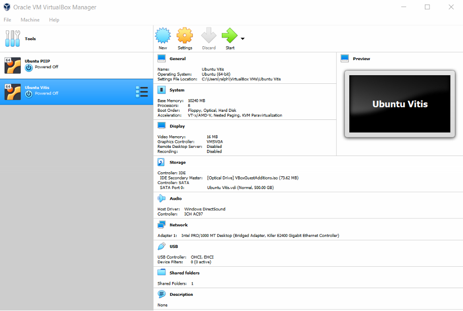

I've been using a VirtualBox VM for the Path II Programmable projects installed on a Windows 10, i7 computer with 16GB of memory (10 GB allocated to the VM).  I was somewhat surprised by the 32 GB minimum memory requirement as I have been relatively satisfied with using the 10 GB for Ultra96 development using Vivado, SDK and PetaLinux (the most time consuming activities are the PetaLinux builds).  I've ordered some additional memory to upgrade my computer to 64 GB but decided to see how far I could get with my existing hardware configuration.  I am using Ubuntu 16.04.4 with the 2018.3 tools in the VM to be compatible with the Path II Programmable training courses, so I needed to create a new VM using an Ubuntu version compatible with the 2019.2 Vitis tools.  I decided to use 18.04.2 but mistakenly downloaded and installed 18.04.  I did not realize my mistake until I was installing Vitis and got the incompatible OS warning.  Short of doing a complete installation, I don't know of a simple way to upgrade to a specific minor version so I decided just to upgrade to 18.04.03.  When I install the additional memory I'll go back and do the whole installation over with 18.04.2.  I will also try to get some quantitative memory usage data using the system monitor utility.  I'm hoping to be able to get a real profile of memory usage.
Here is my current VM configuration:

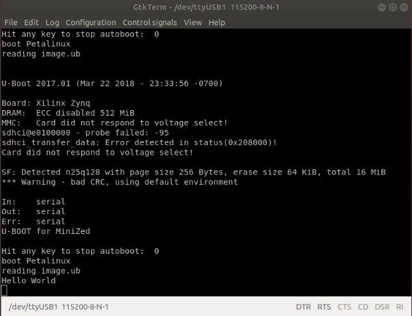

The standard "pipe cleaner" test to verify the software/hardware setup is the "Hello World" application and Adam's tutorial also goes through that process.  The program is run using a debug configuration through the JTAG/UART port on the MiniZed.  The program ran successfully but I got some error messages that refer to U-Boot trying to use the SD Card which doesn't exist on the MiniZed.  Not sure where that's coming from but I'll need to figure it out.  I don't see that mentioned in the tutorial so I have an error in my setup or I've missed a step.
I'll spend some time looking at that before continuing on.  I also don't have the Pmod HB3 H Bridge that is required to complete the tutorial.
