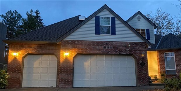

I recently started having problems with an LED bulb "burning out".  I've used LED filament lights for a few years.  I have noticed that they don't seem to have the lifespan of the more prevalent individual chip on substrate lights that I normally use.  If the chip on substrate LEDs fail early it is usually due to the LEDS having a poor bond to the heatsink which causes thermal induced failure (once I had a component fail in the current source).  These filament bulbs normally seem only to last 2-3 years @ ~4000hrs/year.  I use them in my outdoor garage lamps to get the old style "filament" appearance.
One of my older filament bulbs started to get dim, so I replaced it with a new one.  After about a week I noticed that the new bulb was also dim.  I verified that the bulb itself was bad and replaced it with another new one - only to have it also fail after a few days.
This bulb is on a circuit with with 4 other bulbs (3 lamps on the garage and 2 on my entry).  All of the other bulbs are doing fine.
In old incandescent bulbs this would usually indicate an intermittent socket contact causing the filament to burn out..
These are the bulbs that I'm using:
Vintage Dimmable Edison LED Light Bulbs 100W Equivalent, E26 Base ST64/ST21 8W LED Filament Bulbs, 2700K Warm White, 1200Lumens, Antique Clear Glass Light Bulbs.

But nothing that suggests that this is a typical early failure mode.  I doubt that it is caused by bad filaments since they all went dim at the same time.  More likely caused by the electronics in the socket base.
Anyone else experience this type of repeated failure where only a single bulb in a parallel circuit is going bad?  I guess I'll have to deconstruct the bulb to determine what actually failed.  I noticed that this is a "dimmable" bulb.  At least now I have a couple of bad ones to play with image.
