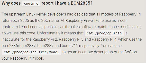

I was expecting that the processor cores might report incorrectly as ARMv7 because it is using a 32 bit OS, but I was surprised that the Hardware (SoC) reported as BCM2835 instead of BCM2711.  Apparently this is a well known issue and I never checked it before.
At least checking the model does verify it is an RPi4.
The memory and disk checks reported as I expected.

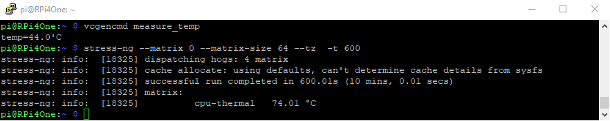

Next step is to verify the cooling performance.  I checked the CPU temperature rise after running the stress-ng stress test for 10 minutes.
  • Ambient temperature: 25C
  • Idle Temperature: 44C
  • Stress test temperature: 74C
It seems with the slow fan speed that the temperatures are well below where the frequency throttling would occur (80-85C).  If I needed to run the fan at high speed I had considered trying a PWM controlled fan like the one used on the Jetson-Nano.  Unfortunately that's a 40mm fan and the case fan is a 30mm fan.  I'd probably 3D print a custom case like fmilburn if I wanted to use the PWM fan.
