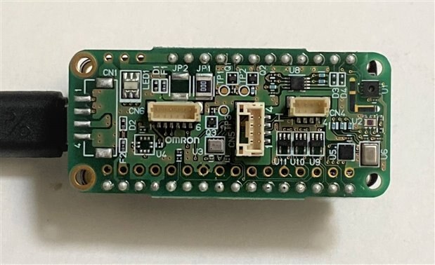

When I arrived home after my morning walk with the granddog, I found a Fedex package on my doorstep.  It was an Omron Sensor Evaluation Board 2CIE-EV that I had won in an Omron giveaway contest.  And it was also green image.
There are 3 different versions of this board, in Raspberry Pi, Arduino MKR, and Feather form factors.  I had won the Feather version, 2JCIE-EV01-FT1 https://components.omron.com/sensor/evaluation-board/2jcie .
The board has 6 onboard sensors and connectors for other sensors.  They even provide 4 cables to enable external connections.
The only Feather that I had handy to use was a HUZZAH ESP8266.  I had been using it to test I2C sensors, so the only pins that I had soldered were 3.3V, GND, SDA, and SCL.  So, it seemed appropriate to try one of the onboard I2C sensors.
Omron has a GitHub repo for this board https://github.com/omron-devhub/2jcieev01-arduino .  I decided to try the program for the SHT30 Humidity and Temperature sensor.
Here's the sensor board mounted on the Feather:

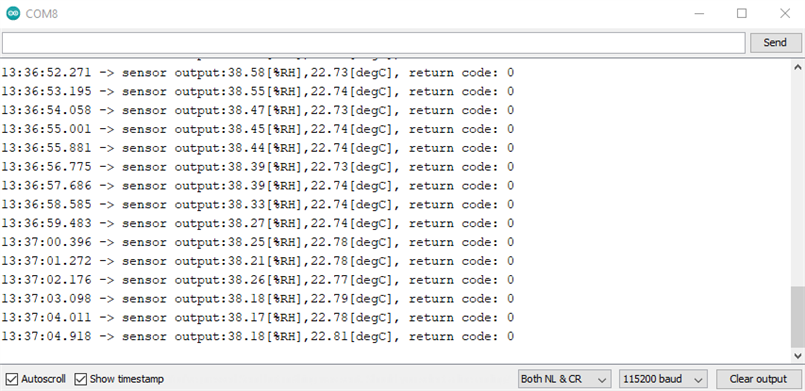

And the output on the Serial Monitor
The GitHub code is written for an ESP32, so I had to change some of the GPIO assignments - but because I don't have those pins soldered, it didn't matter anyway.  LED1 is an RGB LED and those pins would have just toggled the colors.
