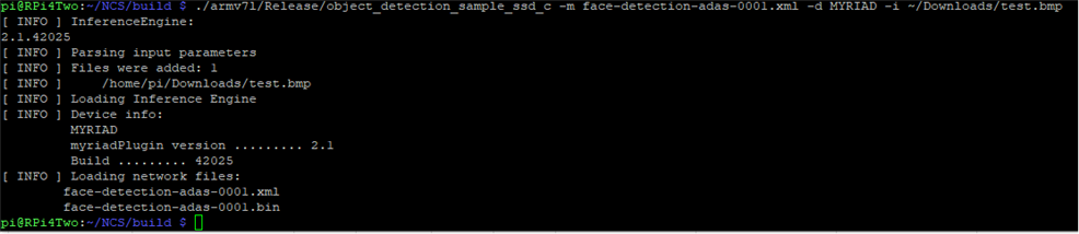

Installation failed!
     Or at least I think it did.  What is supposed to happen is that "The application outputs an image (out_0.bmp) with detected faced enclosed in rectangles".  Well, I don't see an image file created and I don't get any error messages.  The documentation isn't very helpful in that there is no sample image provided or an indication of where the expected output would go (I presume the directory you execute from but I can't find it there or anywhere else) and no indication of what the expected messaging is for a successful execution.  Here's what I see:
At least it appears to be at least running something.

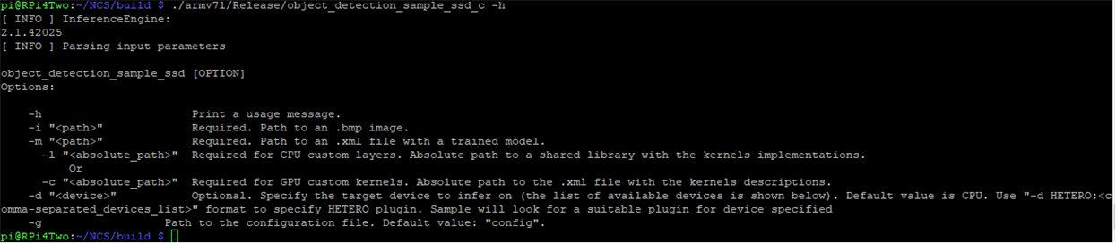

I did determine that it seems to want a BMP image.  I gleaned that from running the command with the -h option:

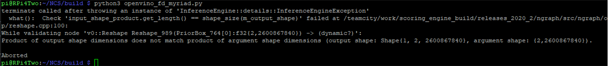

I also tried running the OpenCV API Python example but unfortunately the error was not something that I can make sense of:
