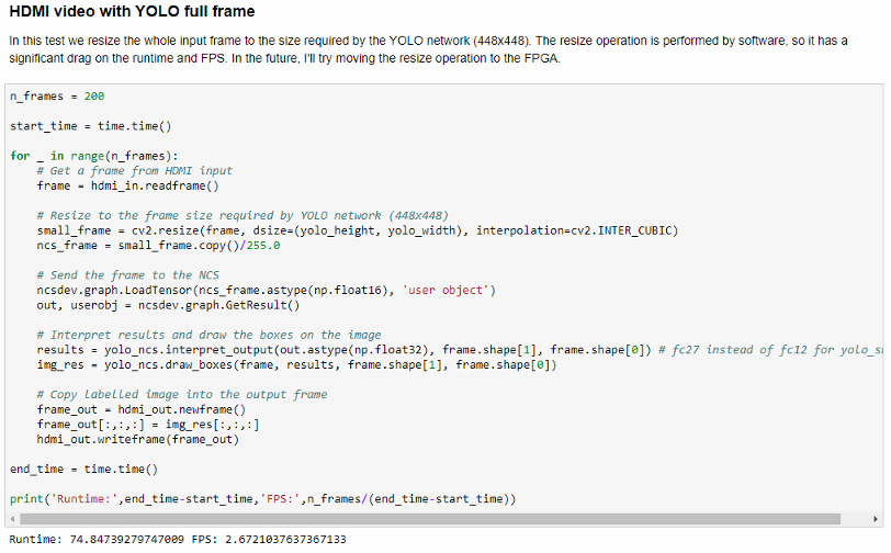

Here is a run through the HDMI notebook.  I have the camera set to 1080p@60fps.  My understanding is that the base overlay does not allow you to set the HDMI input and output resolutions - the received input mode is copied to the output.
Since YOLO uses a 448x448 image size, you can either cut out that size from the input frame or you can resize the input frame.  Both methods are used for comparison.
So the 60 fps input rate is maintained.
Just under 3 fps rate for classification.

About 10% slower for classification.
