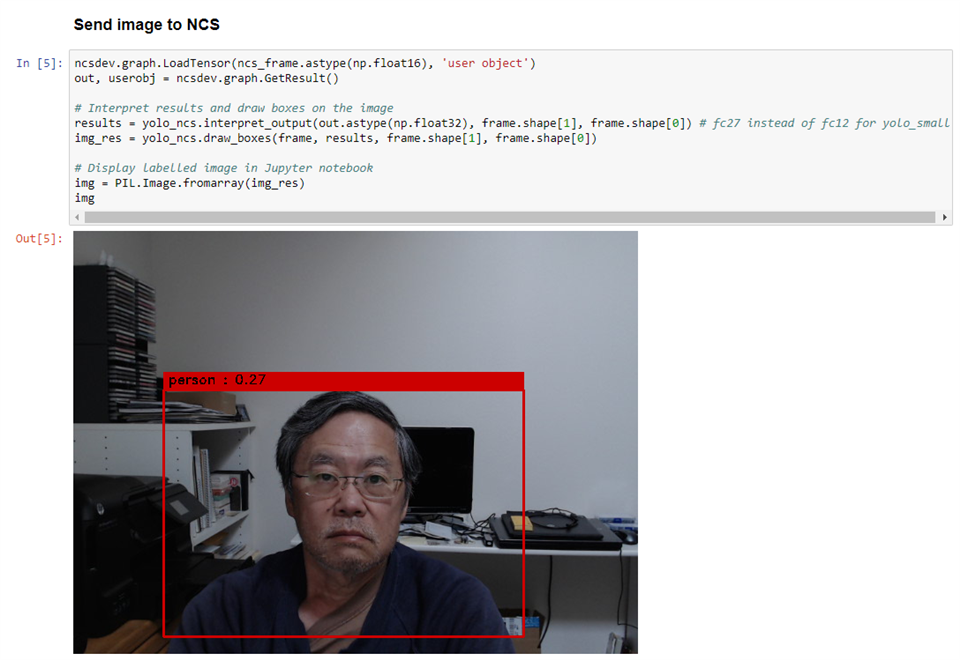

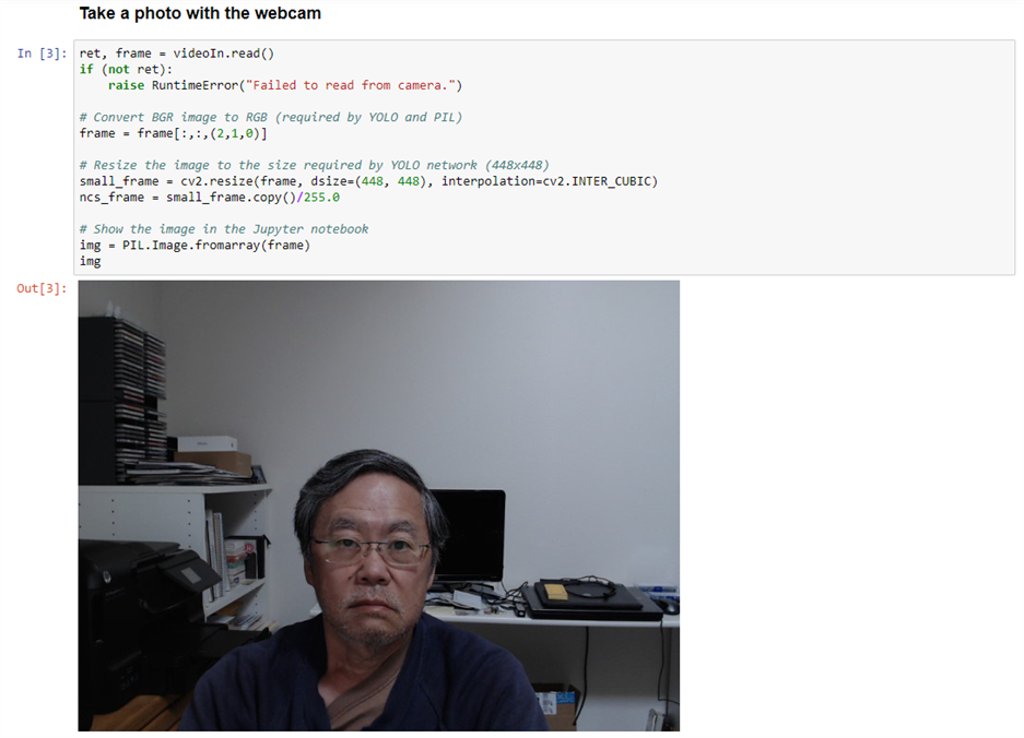

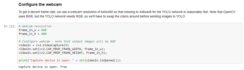

My next surprise occurred when I went to test the YOLO webcam example that I had tried with the PYNQ-Z2.

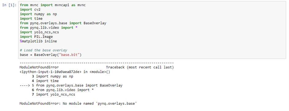

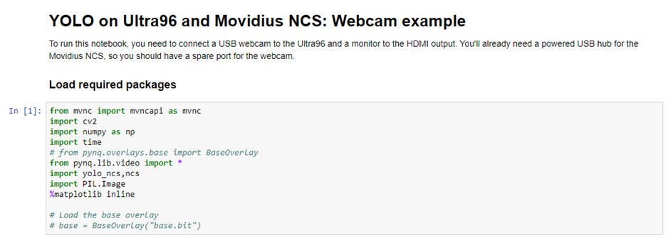

The PYNQ V2.5 image for the Ultra96 does not include a BaseOverlay (none of the Ultra96 versions do).  This notebook was using the BaseOverlay to send video to the HDMI output (DisplayPort).  I had previously used PYNQ on the Ultra96 with pynqOpenCV notebooks that do not use the HDMI output.  Once I commented out the BaseOverlay, I was able to run the non HDMI cells in the notebook.

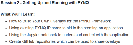

Now I need to come up with a project that uses the NCS on the Ultra96.  I'll need to see if there are existing overlays that I could use or I may need to build one.  The good news is that Adam Taylor is doing a workshop next Tuesday that includes building PYNQ overlays.  The workshop is using the PYNQ-Z2 but the methods should apply to the Ultra96.
PYNQ-Z2 Workshop: Getting Up and Running with PYNQ
