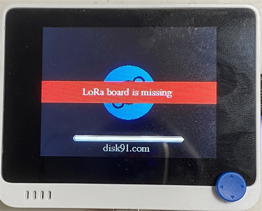

Looks good so far until the program restarts:
It doesn't see the LoRa-E5 module.  This expansion chassis uses two UARTs - the hardware Serial1 for the LoRa and a SoftSerial one for the GPS.  There are some comments in Paul's documentation about problems with the UART configurations, but I assume that should be fixed in the prebuilt binary.
I tried another version of the application modified by a Seeed engineer and got similar results.
Except in this case the program allowed me to continue and I saw the GPS was working.
I reached out to Seeed tech support, but they just had me try what I had already tried even though I had written precisely what steps I had taken (I guess tech support assumes you don't know what you are doing and probably doesn't read what you send them).
Anyway, I got frustrated and requested an RMA.
I got in touch with Paul through his github repo and he was helpful.  I ended up compiling the program with debugging enabled and it basically told us what we already knew - the LoRa module wasn't responding.
So, what was the bad assumption that I made?  I assumed that the new LoRaWAN chassis was broken.

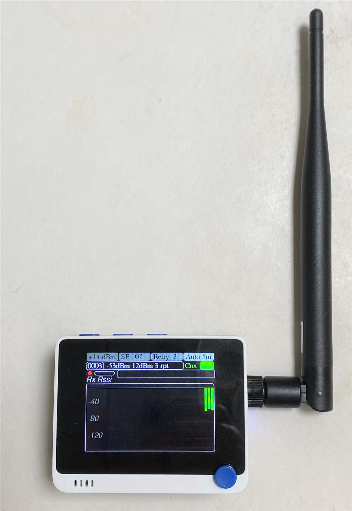

I have another Wio Terminal that I've been using for a thermal camera and I swapped it for this one and now everything works as expected!
Below showing the RX RSSI from my gateway.
So, I've cancelled the RMA (admitted I was wrong).  I've labeled the bad Wio Terminal.  It's still useful if I don't need Serial1.  I'll create SoftSerial ports if I need UARTs.
