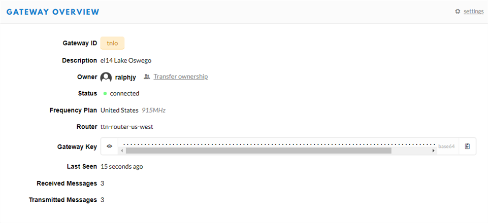

It has been a while since I received The Things Network (TTN) LoRa Gateway and two MKR WAN 1300 boards for winning the IoT in the Cloud challenge.  I've been busy with roadtests, but really would like to start playing with LoRa based sensors.  I checked in my local area and there are 5 gateways listed on the TTN map.  One is a Things Gateway like mine, two are homebrew (RPi/Arduino) and two are unspecified.  The closest gateway to me is about 4 km away as the crow flies.  It's possible that I could manage to get a connection to TTN through that gateway.  Being anxious to get started, I decided that I would just bring my gateway on-line and worry about signal strength testing later.
The setup process is straightforward but a bit anomalous.  You create an account with TTN and then use a browser based setup process.  The configuration initially requires that you go to the activation website and then connect to the gateway through its WiFi access point.  I was using a desktop computer that did not have a WiFi interface so I couldn't continue.  I had to switch to my iPad and run the configuration with it.  I guess they presume everything has WiFi nowadays.
Anyway, got everything configured and the gateway activated.  I am running indoors with the antenna that came with the unit, so I'll have to see how much range I can get.  I've read some discussions that the range could only be as short as 0.5 km depending on the construction of the house (materials, etc.).  That would be fine for me since I have a small lot, but it probably wouldn't provide much value in extending the TTN network to others.  We'll have to see if I get any external traffic.
I successfully ran the "hello world" program on one of the MKR WAN 1300 boards.  It just sends the text "hi" to the TTN console.
Here is the description of my gateway:
And the gateway with 4 solid LEDs indicating alive and connected to TTN.  The fifth LED blinks to indicate traffic.
