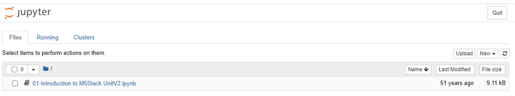

I've found Jupyter Notebooks to be very useful for interactive Python development.  I first started using them with the PYNQ-Z2 and most recently running machine learning models in Google Colab.
I had hoped to see a few AI example notebooks on the UnitV2, but it turns out there was only a single example notebook covering basic interface functions - check Python version (3.8), control LEDs via GPIO, communication over Grove UART, camera image capture and display.
It's funny that the notebook was last modified 51 years ago image.  I had updated the system time (it hadn't been set, so was running from the beginning of Linux time - 1970).
Introduction to M5Stack UnitV2.ipynb

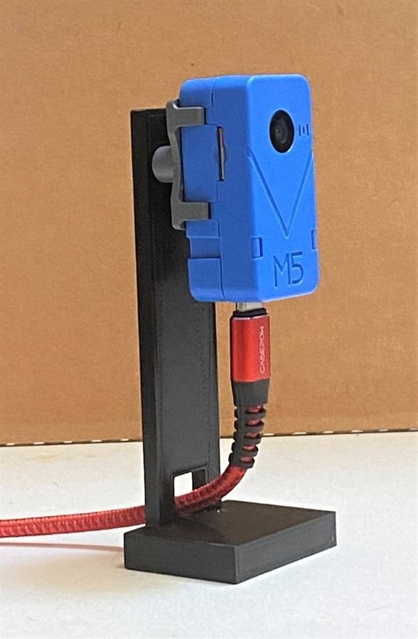

I decided that I needed a simple desktop stand for the UnitV2 while I'm playing with programming.  Using the tripod mount with a short tripod takes up too much space.  Good news is that the unit also comes with a Lego Mount Clip, so I just printed a short stand that works great image.

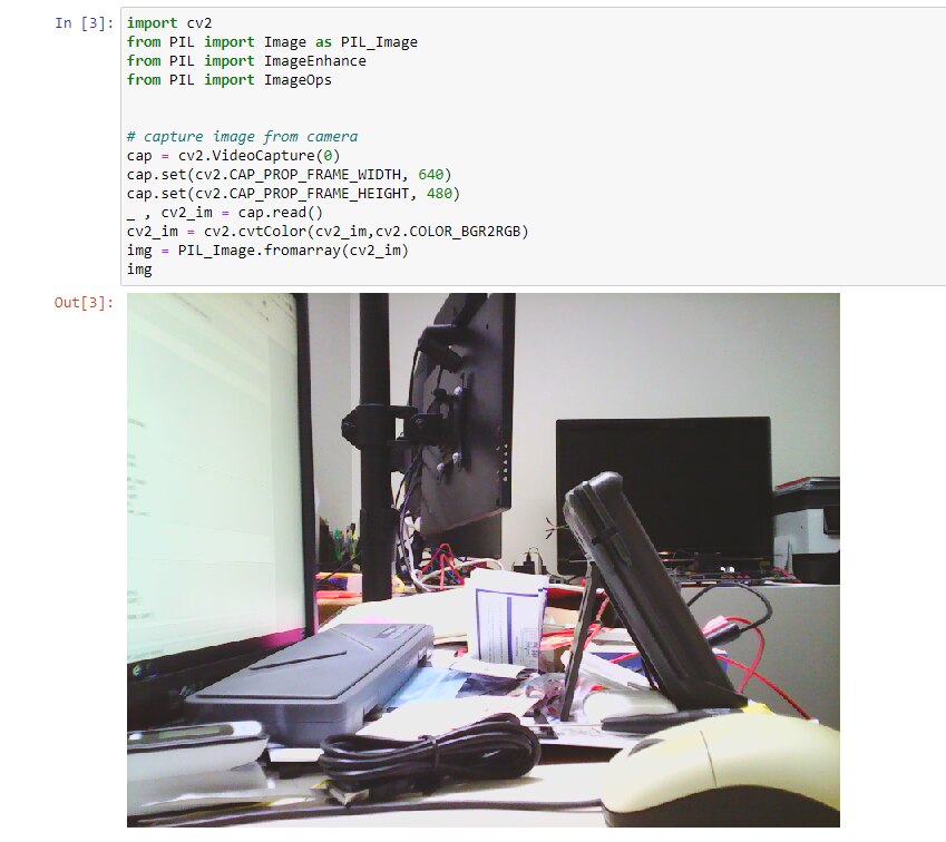

The camera is connected to the processor via USB, so it looks to the system like a USB webcam.  Here's a picture of my messy desktop:
One thing I discovered is that I wasn't able to set the camera to FHD (1920x1080).  As a matter of fact, I was only able to set 640x480@15fps and 320x240@30fps.  I couldn't set any resolution higher or lower.  I'm not sure if this is a function of the camera driver.  I've posted a question on the M5Stack forum.

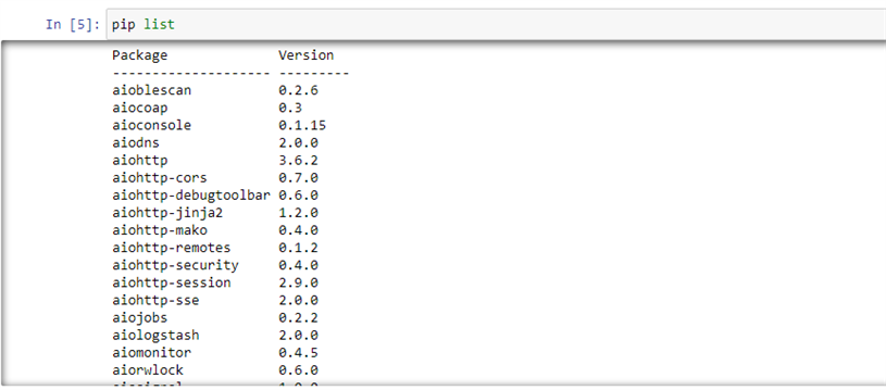

Another issue I encountered is that a number of the utilities that I use with OpenCV are not installed, so I'll need to fix that also.
Full list of installed modules is below:
