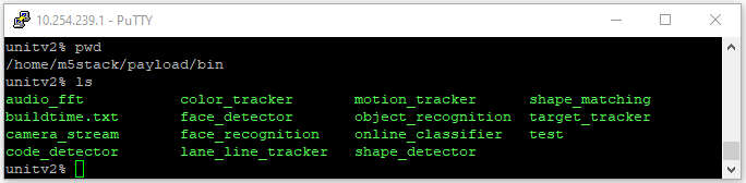

The OOB applications are located in the /home/m5stack/payload/bin directory:

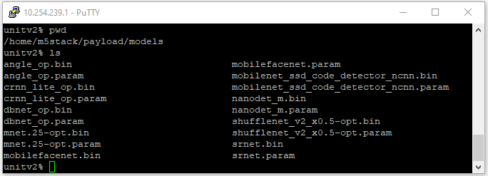

The associated Neural network models are located in the /home/m5stack/payload/models directory.:

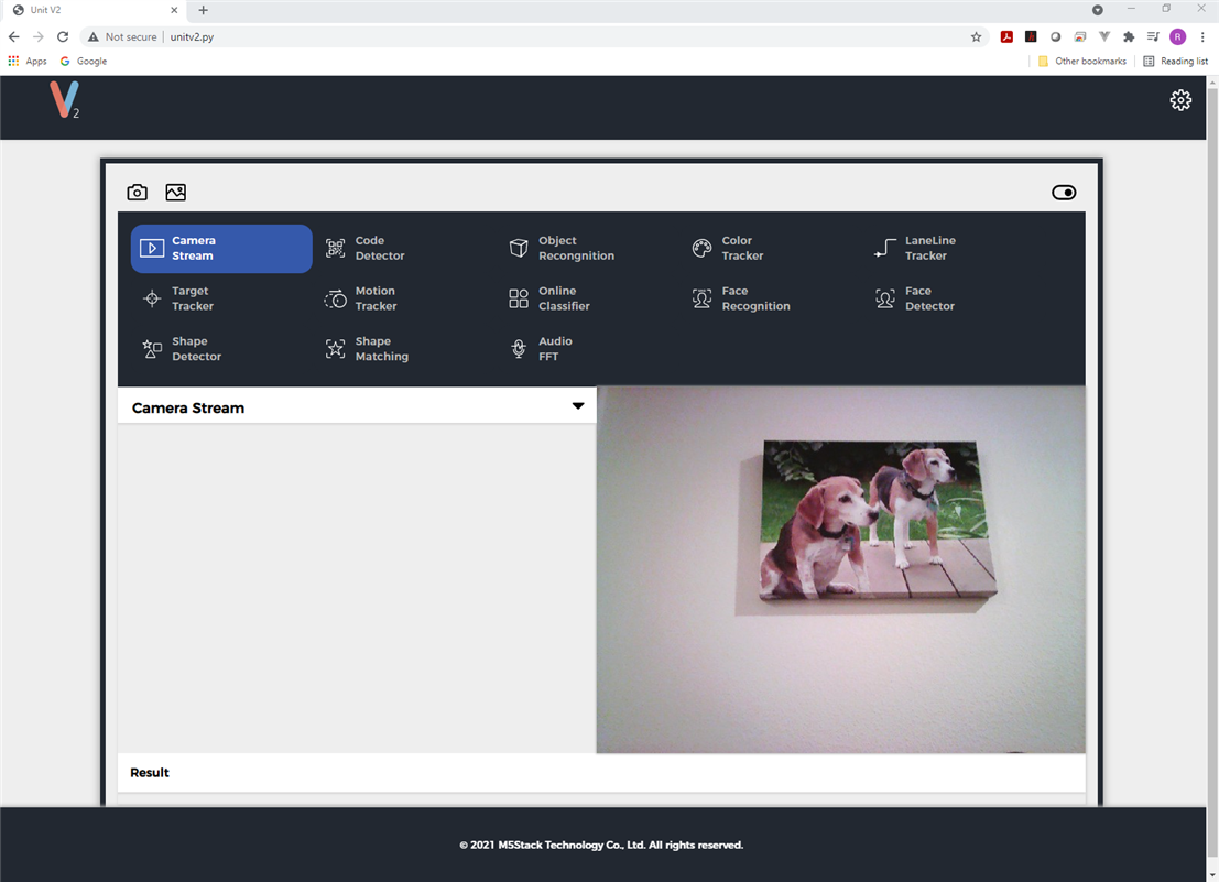

To run the OOB Application Framework you need to open unitv2.py in a browser window:
The Framework defaults to starting with a real-time VGA camera stream.  The above is a picture of my previous Beagles that is just above my monitors.  You can configure which app is the default as shown below.  You can also switch to using Jupyter Notebooks for interactive development.  I'll cover that in a separate post.

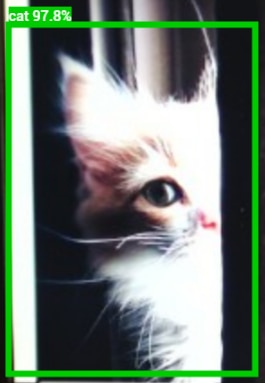

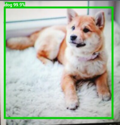

There are 13 examples applications in the OOB Framework, so I thought that I'd demo the Object Recognition example.  This example has 2 different models, yolo_20 and nanodet_80.  I tried them both and they have similar results. I found a database of pet photos at https://www.pexels.com/search/pets/  and I'll open that on my second monitor to test the object recognition.
Sorry for the shaky video - some of the mis-classification is due to the positioning of the camera on the image on the monitor.

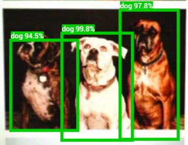

The classifier did pretty well with dogs and cats and a bird:

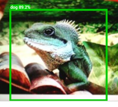

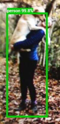

The classifier had some problems with the Beagle because it sometimes wanted to classify the chair because of the distinct material ribbing.  The Lizard is mis-classified because it isn't represented by a class.  The dog with the glasses will classify correctly if I pull back from the image.  And the classifier doesn't seem to be able to separate people from animals when they are overlapping.
