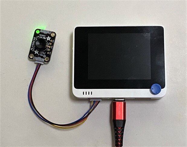

I'm want to use the MLX90640 Thermal Camera module from Adafruit with my Wio Terminal to make a diagnostic tool that I can use for thermal measurements.  I tried out a module with a 55 degree FOV lens with Jupyter Notebooks on my PC Using the MLX90640 Thermal Camera with Jupyter Notebooks .
Now I'm going to try out a module with a wide angle 110 degree FOV with the Wio Terminal.  I'm using a STEMMA-QT to Grove cable to connect the modules, so I can easily swap modules to change the FOV.  I also need to 3D print a holder so that I can attach the module to the back of the Wio Terminal (I'm going to create a dummy header to plug into the RPi connector).
First, I need to try out some software (I'm using the Arduino IDE).  It seems that each board manufacturer has their own variant of the sensor library and different examples are included.  I had used the Adafruit MLX90640 library with the example that I used with Jupyter Notebooks.  I decided to try the SparkFun library next.  That library has an example that sends the sensor data as a serial stream over USB to a Processing app to visualize the data.
Here is base setup (I still need to figure out how to mount the camera module, but it's easier to take selfies with the camera loose).
And a short video of the data visualization.  I wearing my glasses in this one.

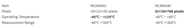

Of course, the whole purpose of using the Wio Terminal is to show the data on its built-in LCD display. So, I switched to using the Seeed Studio library which supports both the MLX90640 and MLX90641.  The MLX90640 has a 32x24 pixel array and the MLX90641 has a 16x12 pixel array.  The MLX90640 is spec'ed for a commercial temperature range and the MLX90641 for industrial temperature range.
The Seeed library has an example of using a Grove MLX90641 module with the Wio Terminal.  I needed to adjust array sizes to handle the larger sensor of the MLX90640 and also corrected a mistake in the Celsius to Fahrenheit conversion.  The one thing that I could not get working was using sprites with the display.  I assume the code did work with an MLX90641.  It could be that I'm encountering a memory issue with the larger arrays.  Anyway, I'm doing it without using sprites - reduced the refresh rate and inserted a little delay in the loop.  I'll try to figure this out later.

  tft.setTextColor(TFT_WHITE, TFT_BLACK);
  sprintf(buf, "%2d/%2d", MinTemp, (int) (MinTemp * 1.8) + 32);
  tft.print(buf);
And another short video.  The temperature displayed at the top is the temperature of the pixels in the crosshairs in the center of the image.  In this video I don't have my glasses on.
Next, I need to add the battery pack and mount the camera to the side opposite the LCD and I will have a standalone thermal camera image.  I'll post when that's done.
Here is the link to the finished project: Wio Terminal Thermal Camera
