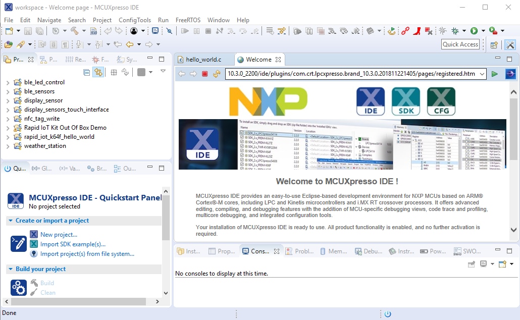

The following shows the example programs loaded in the IDE.

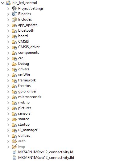

For my test of MCUXpresso I am going to use the ble_led_control example.  The project files are shown below.

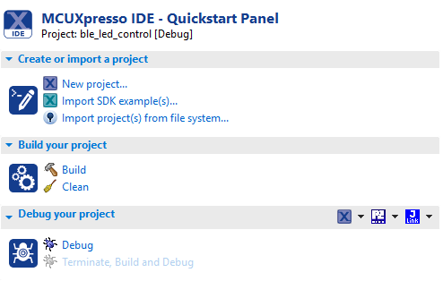

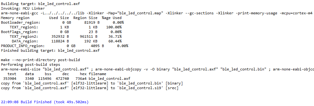

First step is to select the project and build it from the Quick Start Panel.
The result of the build is displayed in the Console Window.
The final step is to connect the Rapid IoT to the computer in Mass Storage mode and copy the ble_led_control.bin file to it.

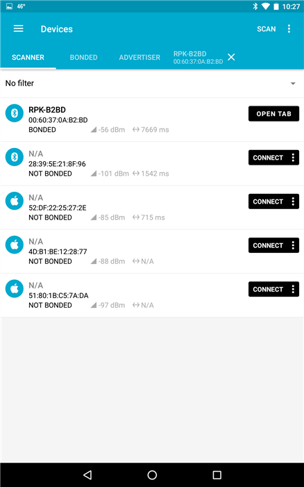

Here is a result of the BLE scan after I successfully paired the Rapid IoT (RPK-B2BD).

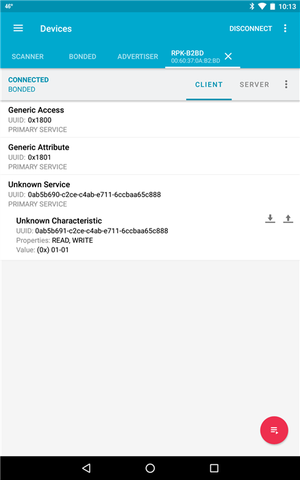

The client panel shows the RGB LED read/write service for the Rapid IoT.

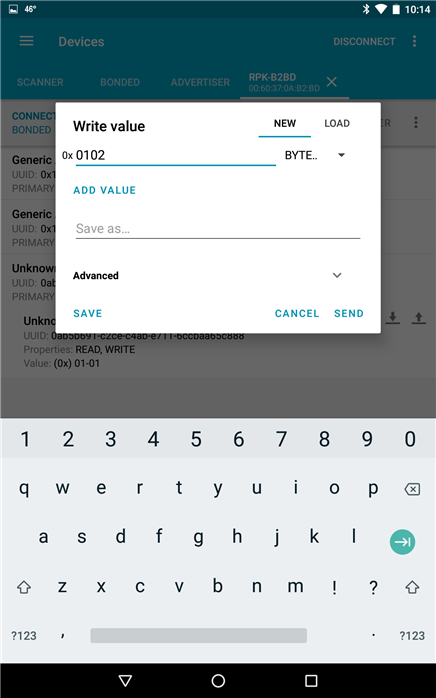

Opening the write panel allows values to be entered for the LED luminosity and color.
