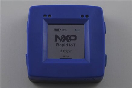

I've used the OOB (Out-of-Box) Demo to familiarize myself with the Rapid IoT kit and I thought that I'd describe its functionality and provide a short critique before I move on to creating my own programs.
The OOB Demo allows you to configure the settings on the device and to  try out all of the sensors.  It also allows you to connect to either an iOS or Android phone/tablet using apps that are provided.  And you can also connect to a Rapid IoT Dashboard in the cloud by using the WiFi connection of the phone/tablet or a Thread router/gateway.

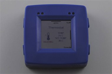

The Rapid IoT device has 4 capacitive touch buttons (T1-T4) that are located under the faceplate at the 4 sides of the screen.  These buttons allow you to navigate through the various screens of the OOB Demo.
There are also 4 pushbutton switches (SW1-SW4), two on each side of the case.  These buttons allow you to make selections on the various screens.
Along the top of the screen (from left->right) there is an RGB LED, the ambient light sensor, and blue and white status LEDs.
Starting at the Welcome Screen you can traverse to 4 other sections listed below.  The demo is fairly intuitive.  A short bar will appear on the top/bottom/left/right to indicate if you can traverse to an additional screen using the appropriate touch button.

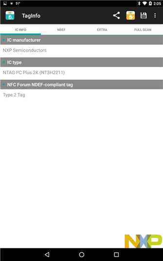

Since I have NFC capability on the Nexus tablet I decided to try reading the NFC tag in the Rapid IoT device using the NXP NFC Reader app that I have on the tablet.
Happily, this just worked and indicated that it is a 2K Type 2 tag.

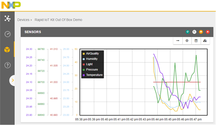

The final thing that I wanted to try with the OOB Demo was to connect to the cloud and display the Rapid IoT sensor data.
I logged into my account at NXP: https://rapid-iot-studio.nxp.com/ , found my Rapid IoT device on the dashboard and added a few sensors to a datagraph widget.
Everything was very straightforward and I had no issues but I did notice that on subsequent attempts that if you re-provision your device (disconnect and reconnect to phone/tablet) that you will have a different new device instance.  I guess this makes sense but you need to delete the previous devices or the dashboard gets to be confusing.
