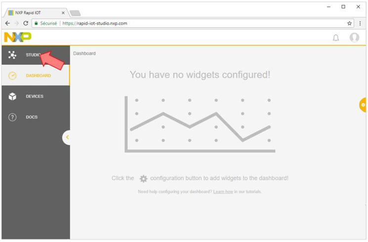

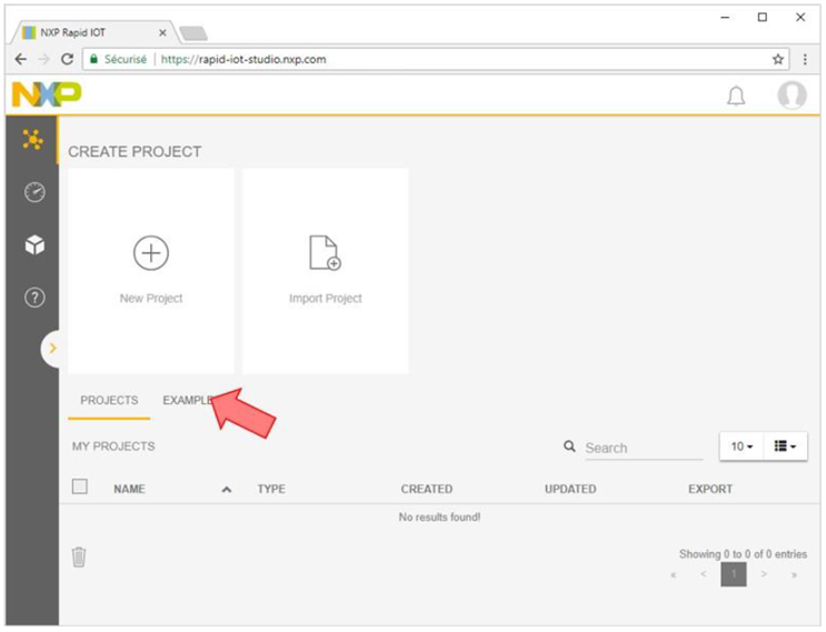

The Rapid IoT Studio IDE is located at the same URL that we used for the Dashboard: https://rapid-iot-studio.nxp.com/ .  It is located on the tab directly above the Dashboard tab.

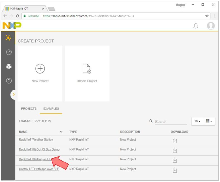

The IDE comes with example projects for the Rapid IoT.

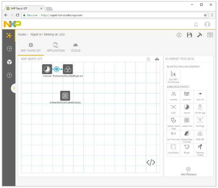

I am going to start by just by compiling the "Blinking an LED" project and creating a binary executable to program the Rapid IoT.  If that works I can then proceed to creating my own program.
The project consists of a set interconnected functional elements that determine the program actions.  You click to drop the desired elements from the toolbox on the right and then just drag the connection line between the appropriate elements.

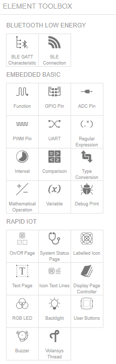

Here's the Element Toolbox:
This Blink project has just 3 elements:
1) Interval Timer to trigger the LED toggle
2) The RGB LED element in the Rapid IoT
3) Label for the Rapid IoT display

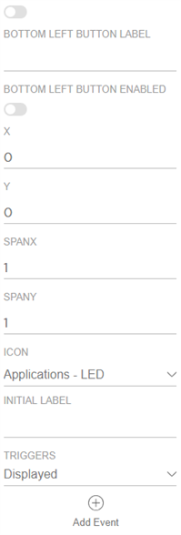

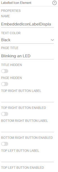

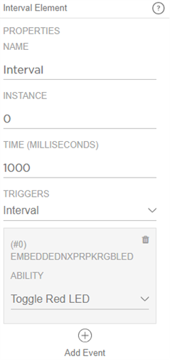

Here are the element properties:
__________________________________

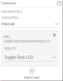

Here are the Connector properties:
Once all the elements are connected on the workspace you just need to compile and download the binary executable (Blinking an LED firmware.bin).
The Rapid IoT device has a USB MSD (mass storage device) programming mode that allows you to upload applications.
To enter the MSD programming mode you use the following sequence:
In the MSD mode the Rapid IoT will appear as a USB drive and you can just drag and drop the application (.bin) file onto it and that will cause the device to boot into the application.
