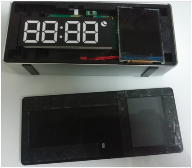

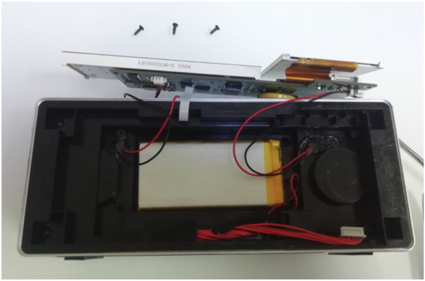

Yesterday I noticed that the front screen of the clock had detached from the case (apparently it is only held in place with adhesive tape).  I could see a very bowed PCB behind the main display and with a flashlight I could see that the cause was a bulging Lithium battery that had swollen enough to cause the case to come apart.  Sorry that I don't have pictures but my immediate concern was to get the power off and the unit into a fire safe container in the garage.  Using appropriate PPE (goggles and gloves) I managed to unmount the PCB and remove the battery.
Here are a couple of pictures from the Onion FAQ that showing the interior of the case:

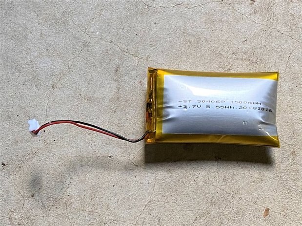

and here is what the swollen battery looked like:
I checked the community posts and I am not the only one to have experienced this problem.  Not sure what the cause of this failure is or if it could have resulted in a fire.  Fortunately, the battery was not hot.

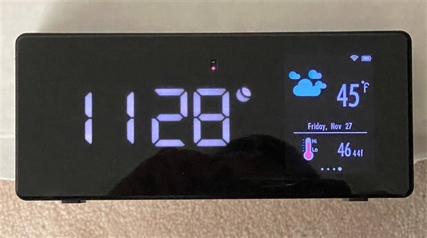

I checked the PCB and reconnected everything and the good news is that it still works.  Luckily there were only 3 screws at the corners holding down the PCB.  If there had been 4 screws I think the PCB would have cracked.
Here is the re-assembled unit:
So, don't know if this was a design problem or a defective battery but I'm definitely not going to put a replacement in there.  I've always been cautious with drone batteries because of the high current and physical abuse but I have lots of these small Lithium batteries in circuits that I should probably worry about and inspect frequently.
