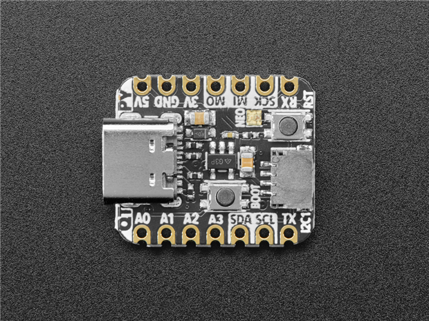

Adafruit now has an RP2040 version of their QT Py:  Adafruit QT Py RP2040 .

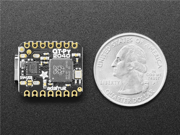

Another nice compact design with USB-C, a Stemma QT connector plus 8MB of SPI Flash and a NeoPixel LED.  It is interesting that they kept the castellated pads, but because the RP2040 and Flash memory are on the underside of the board - you would need to put a cutout in the host PCB to attach it.

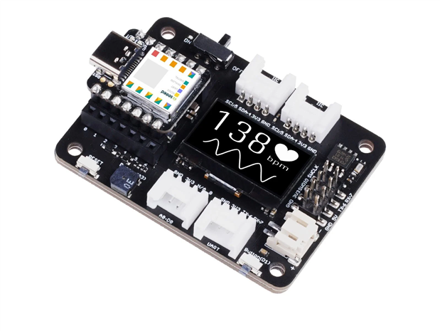

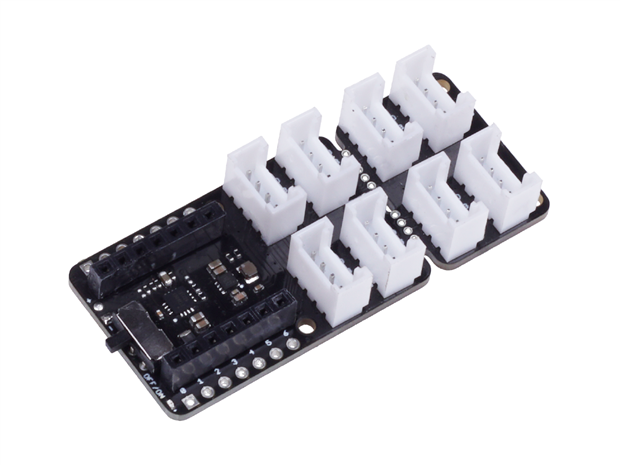

I have a couple of Xiao accessory boards from Seeed that I want to use with with this board - the Grove shield Grove-Shield-for-Seeeduino-XIAO and the Xpansion board Seeeduino-XIAO-Expansion-board .  The QT Py is pin compatible with the Xiao.
I'll need to remove the SWD spring pins from the Xpansion board as they will hit the Flash memory chip.
I decided to try the QT Py RP2040 on the Xpansion board first since it will be nice to be able to use the OLED display and the SD card.  I'm programming the RP2040 with CircuitPython since I've been using it with the Adafruit FunHouse .

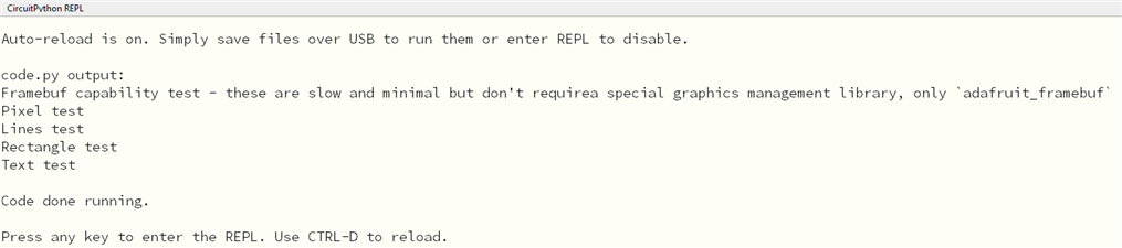

I've found that the one of the tricky parts of using CircuitPython (or MicroPython) is that you need to have the required libraries loaded on the target device (usually compiled libraries - *.mpy - to save space).  I noticed in the Adafruit CircuitPython libraries bundle that each library has a requirements.txt file that lists other libraries that it might be dependent upon.  If you forget a dependent library, you'll get a message like: ImportError: no module named 'adafruit_framebuf'.
For a quick test of the QT Py RP2040 and the OLED, I used the ssd1306_framebuftest.py example with only a few minor tweaks.  The program is renamed code.py so that it will automatically execute when it is uploaded.

Here is the output on the Mu Editor Serial Console:
