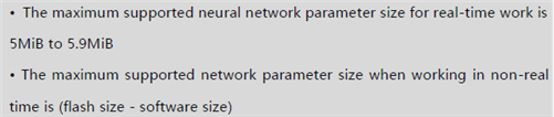

The memory utilization appears to be the tricky part of the setup.  The Maix-1 processor module on the Maixduino has 16MB of flash memory and 8MB of RAM plus the 4GB SD card.  I still have lots to figure out, but it appears that real-time processing is constrained by the RAM size and maximum network model size is constrained by the flash memory size.  I haven't used microPython before but apparently the flash memory is mounted as the directory '/flash' and the SD card is mounted as '/sd'.  A boot.py file is executed upon boot and /sd/boot.py has priority over /flash/boot.py.
Here is an excerpt from the spec:

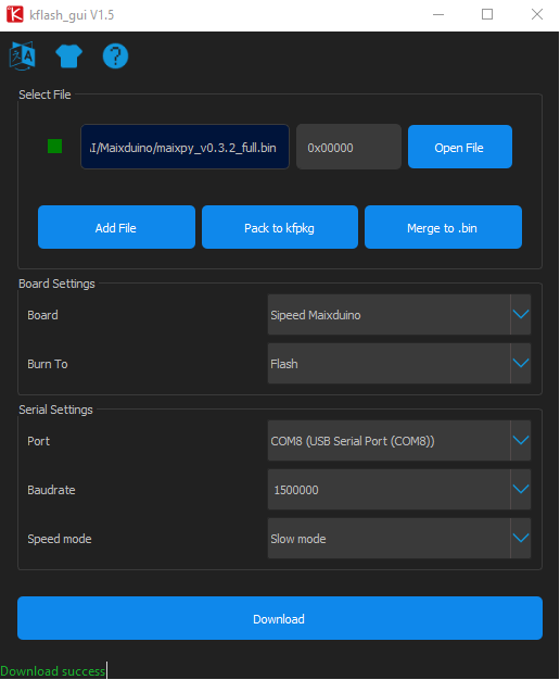

The kflash utility is used to upload the MaixPy firmware and the network models (or other binary files).  The examples that I came across all are using the flash memory.  I'll need to figure out the limitations of using the SD storage.
Below is the kflash GUI.  The MaixPy binary file is loaded at address 0x0000.  The other binaries are loaded at an offset addresses beyond the end of the MaixPy binary.  Here I am loading the "full" version of the MaixPy binary which allows for running remotely from an IDE.  Unfortunately, I discovered that the size of this binary would not allow me to run the neural network examples.  I ended up loading the "minimum" version and not using the IDE.

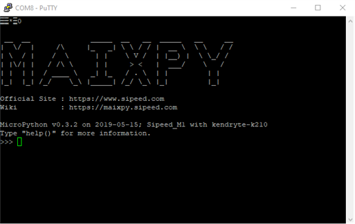

The version of MaixPy that was pre-loaded on the board was v0.1.1 and I updated it to the latest stable release v0.3.2.

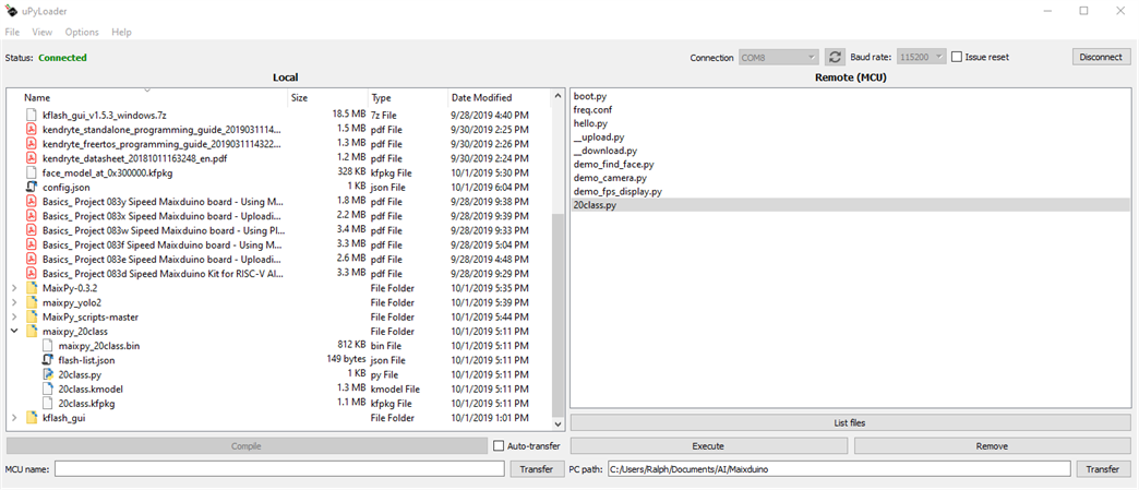

The next utility required was the uPyLoader which enables file transfers between my Windows file system (on the left) and the Maixduino file system (on the right).  This tool also allows for remotely executing Python programs.  And it has a terminal capability for command line execution.

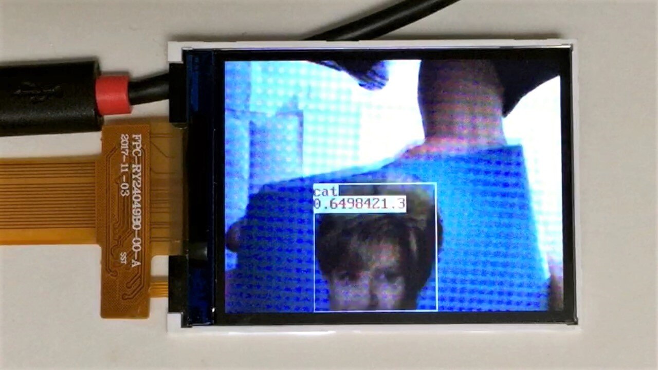

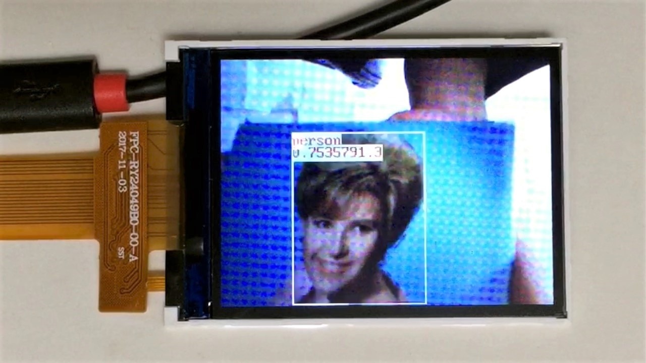

I recorded a short video of the Maixduino classifying objects.  Unfortunately, I still have not figured out how to get a decent recording from these small LCD displays so the images are not very good.  I used a photo of a woman and a dog to test the classifier.  You can see that if the woman's full face is not in the frame that she is mis-classified as a dog or a cat instead of a person.
Here are some frames from the video.  Barely legible.  The frame rates are between 0.5 to 1 FPS which is not great but acceptable.
