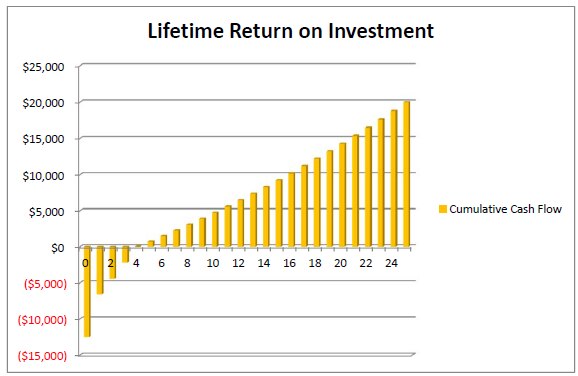

Here is the original ROI projection which shows the break even point at about 4 years:

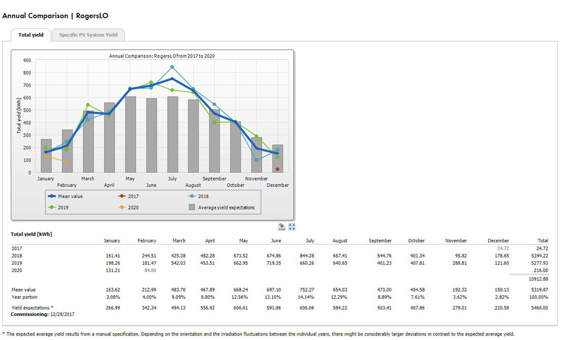

After the first year I readjusted the yield estimates and it looks like we essentially generate what we use on an annualized basis.  So, we're basically running with no excess energy margin.  We have a grid tie system so we only have to pay for excess energy that we use (there's also a monthly infrastructure charge of $12).  With the Net Metering program that we're in, there is no real cost advantage to generating excess energy because they do not pay you for any excess that you generate on an annual basis.  And excess credits do not carry forward year-to-year.  Our true up cycle ends in March.
Here's a view of how we've done over the life of the system versus my adjusted yield estimate (5460 kWr/year):

So, the design fell short of what we had intended.  We're basically running with no margin so that as the panels age our energy production will fall short of our usage.  Our break even point is at about 25 MWh which will occur in just under 5 years.  The system total to date is about 11 MWh.  The net lifetime ROI will still be about $15K because of the State and Federal energy tax credits and the State Energy Trust rebate on installation cost.
