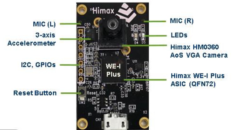

The WE-I Plus has a nice set of features for Edge AI on a compact 40mm x 27mm PCB.  It has a HM0360 monochrome VGA (640x480) camera, dual PDM microphones, LSM9DS1 IMU, plus Red and Green LEDs.  The IO is somewhat limited - one I2C port and 3 GPIOs.  It uses a 400MHz HX6537 ASIC with a 32-bit processor and FPU.

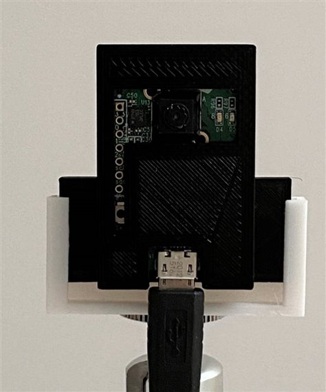

The first step was to print a quick housing so that I could tripod mount the board for ease of use.

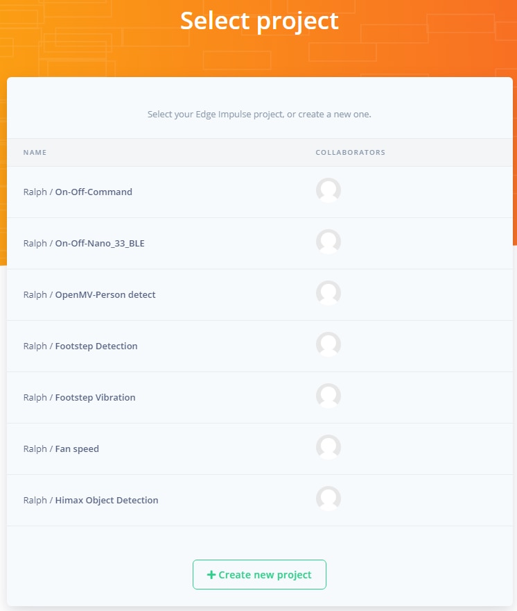

The next step is to log into edgeimpulse.com and create a new project.  In this case I created one named Himax Object Detection.

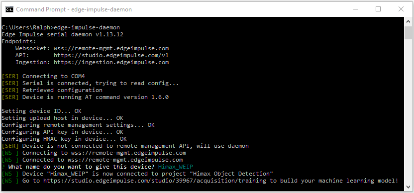

Now at the Command prompt you can start the edge-impulse-daemon which will connect the device to your project.  The first time you start the daemon, it will ask for your edge impulse credentials (name,pw) and which project to connect the device to.  In this case, I've connected previously but not named the device - so it just asks for the device name.  If I wanted to connect to a different project I could have started the daemon with the --clean option.

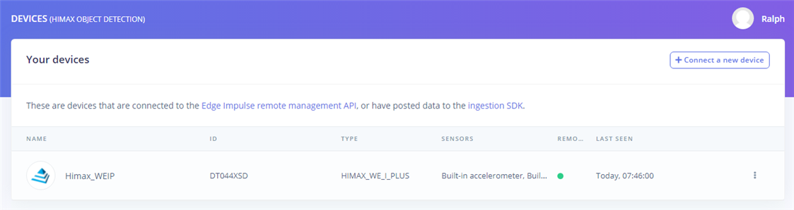

The device will now be connected to the project in my edge impulse dashboard.

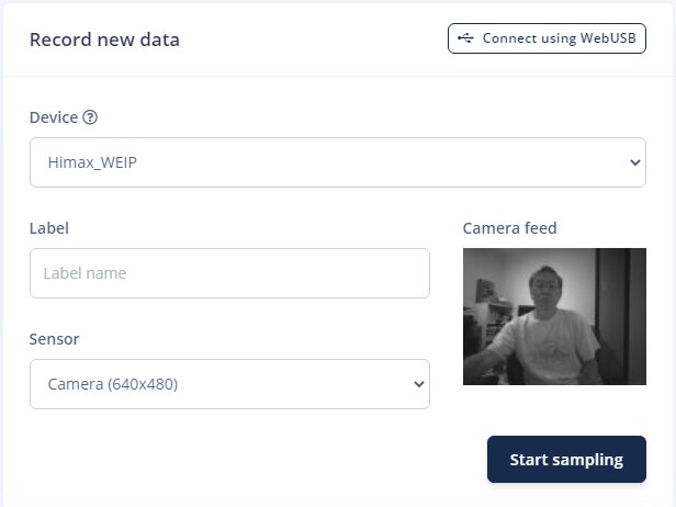

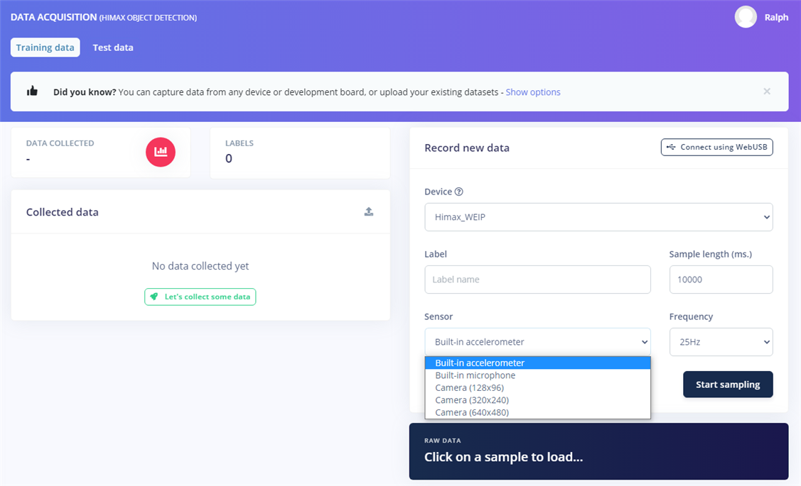

The next step is to collect some data.  In the Data Acquisition window you get the choice of connected device and available sensors.
I'll select a sample of the Camera at 640x480 resolution.  It will give me a live preview in the Camera feed window.  Then I just need to label the data (Ralph) and hit the Start sampling button.

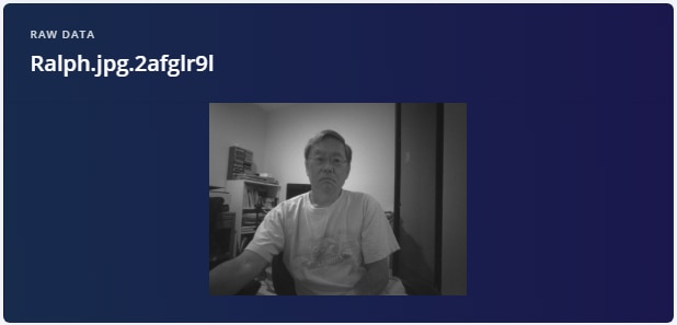

And after a few seconds of upload time, I get the data sample.
