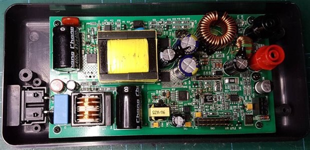

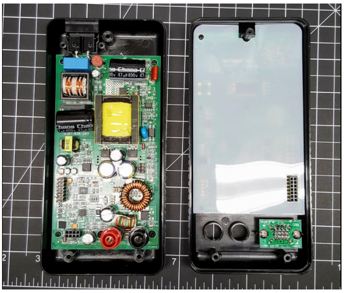

There are 2 PCBs:
  • One attached to the top of the case has the display, buttons, jacks and the microcontroller
  • One attached to the bottom of the case has the power supply circuits
                                                            Logic PCB
                                                      Power PCB

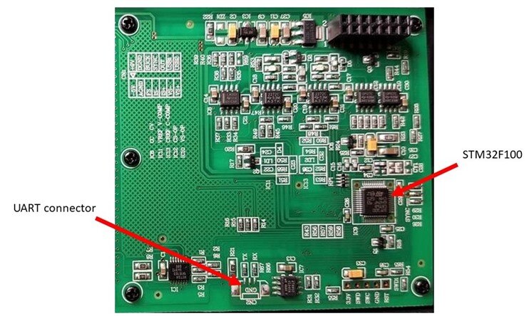

The unit uses an STM32F100 microcontroller for the control processor and there are pads to add a UART connector for communication.  Someone attempted to interface the processor but was only able to get debug information from the serial port.  I've attached the debug output.  It appears that the power supply might be able to be controlled via the serial port which would be neat but it depends on how the firmware is implemented
pcb markings: MPT3050A-V5.6 2015-08-06 QJB7.820.290 698580
sold as PS2002H or Tekpower TP3016M
On the PCB there is CN2 connector with pins: TX, GND, RX. It is a uart at 115200 bauds which
generates some debugging information from STM32F100 processor.
It does not respond to common AT commands, neither to any random characters transmitted over
uart, list of some received messages follows. If you will find out what protocol this device
uses, please let us know in comments section
power-on:
cm_test_mtz success
cm_read_user_zone success
c8 0 90 1 c8 0 2c 1 ff ff ff ff ff ff ff ff ff ff ff ff ff ff ff ff f6 24 0 0 94
2 24 0 43 29 0 0 4 55 d9 ff 3 26 0 0 dc 93 26 0 1f 28 0 0 57 13 d8 ff 5 2 55 5a
Power On Reset occurred....
RCC-CSR:0xc000002
core_init saved da v: 0.946200 235.995605
core_init saved ad v: 1.056300 -253.414001
core_init saved da c: 0.973100 252.822006
core_init saved ad c: 1.027100 -261.648895
core_init ref status:5a
brightness pwm:999
contrast pwm:160
leds active
lcd active
keyboard active
core active
meter active
dcdc active
screen active
dcdc work_mode
cvc active
gpio_usb_switch off
core_set_cv_dac_without_adjust: 0
output-enable:
awd:1011
core_output_key_handler
output-disable:
presets:
storage_read_cvc:0 200 300
storage_read_cvc:1 65535 65535
storage_read_cvc:2 65535 65535
storage_read_cvc:3 65535 65535
storage_read_cvc:4 65535 65535
change-of-value:
cm_write_user_zone success
brightness-change:
brightness pwm:0
brightness pwm:999
contrast-change:
contrast pwm:0
contrast pwm:80
contrast pwm:160
contrast pwm:240
contrast pwm:320
contrast pwm:500
toggle-usb-output:
gpio_usb_switch off
gpio_usb_switch off

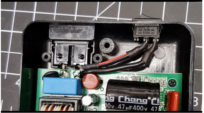

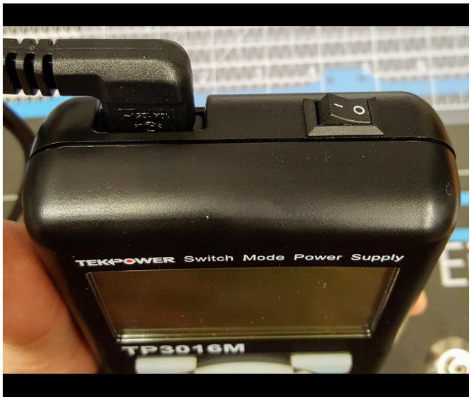

Power switch mod
One of the major gripes in reviews is the lack of a power switch and people have been adding a switch next to the power connector.
