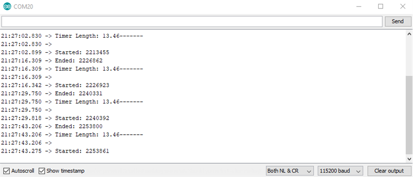

Here is the output when the DIP switches are set for a 5 second delay:
The time indicated is minus the 50 milliseconds the timer takes to reset.  It measures 4.7 seconds which is reasonably close.

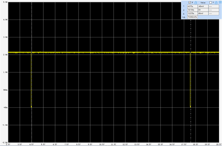

Here is a scope capture of the VDD_OUT pin:
Th scope measures 5.731 seconds - 50 milliseconds = 5.68 seconds (maybe a little less as the reset interval looks larger than 50 milliseconds - I should have set the cursors to measure only the positive duration).  There is more time discrepancy than I would have expected.
Tried it again with a 13 second interval set:
This time a closer match 13.45 vs 13.53 seconds.  Not sure why the 2 measurements are off at 5 seconds, but that time difference won't matter in my application.  I'll probably have the interval set between 1-5 minutes depending on which sensor I'm using.
